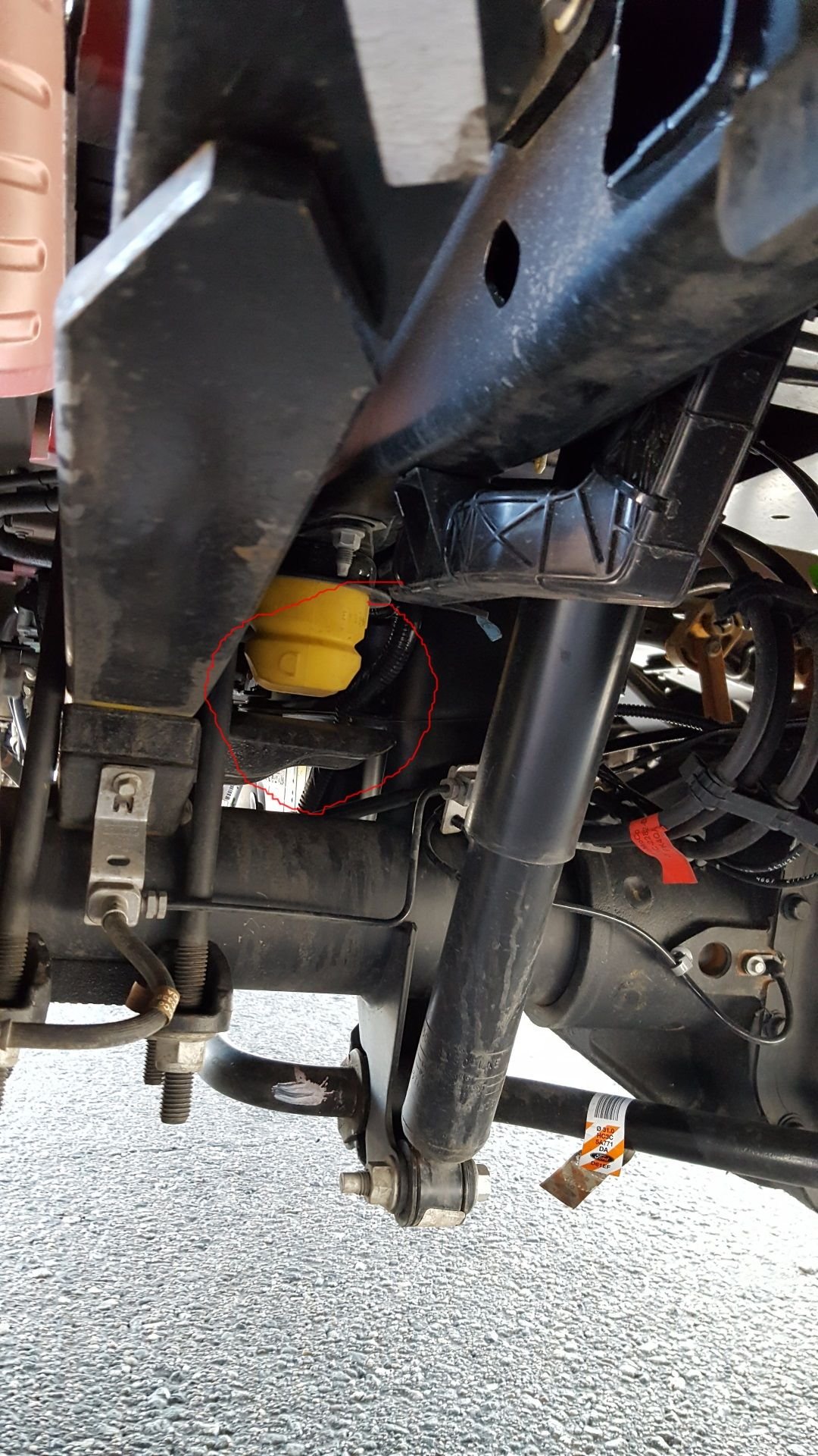

Towing my 43' 23k 5th wheel (4400# pin weight) with my 2018 F450 there isn't much clearance to the bump stop. I think I'm hitting it quite often going over bridges and such. Airbags would smooth this out right?

Those bump stops are "squishy". Thought they may not feel like it by hand, they'll deform as absorb shock as they are compressed.
That being said, if your pin weight really is over 4klb, then airbags would surely help. I have them on my '17 450 for hauling a TC. Love that I can keep the truck level with 4k+ in the bed. No headlights in the sky, no sagging rear end. I recommend the airlift 5000 ultimate, which have an internal jounce bumper. Since the install removes the factory bump stops, if an airbag were to fail the internal bumper is critical to preventing damage to the suspension from over-flexing. Install takes just a couple hours. You need to trim one of the bolts on each side to prevent interference with the sway bar (a hacksaw could do it).
