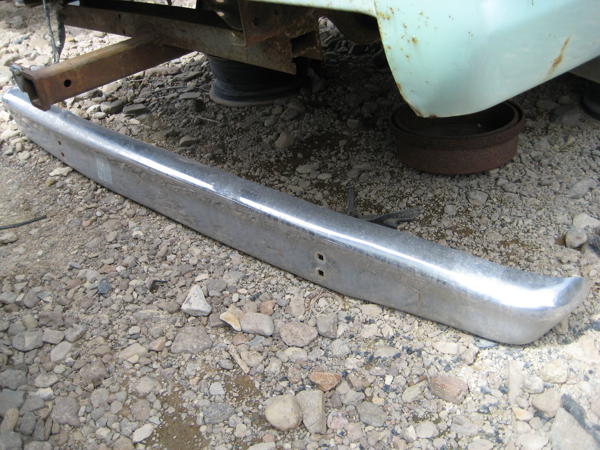

On my recent journey to a couple of my local JYs I spotted a few contour bumpers. I've done some searching on the forum and found answers to some of my questions (can't use bumpside brackets like I had hoped when I found some, santa claus isn't real), but still have a couple.
I will post pics to show you what I'm looking at after I ask my questions. My first question. Do any contour bumpers after 79 fit out trucks? I found a 78 Bronco with a contour bumper along with a couple mid 80's Broncos with contour bumpers and they all look the same at a glance. I'll probably snag the bumper from the 78 later on, but one of the bumpers from the mid 80's Broncos looks to be in a little better shape.
My second question. At one of the yards there was a 77 Supercab ranger xlt (don't remember if it was a 150 or 250) and as I went around the back of it to see if there was still a bumper intact I saw what looks like a contour bumper, but without the spot for a license plate. Is this a factory Ford bumper? Am I simply looking at a front bumper that someone dropped behind the truck as some kind of ploy? I'm assuming it belonged to the truck only because it was directly behind it on the ground. What do you think?
Pics, for your pleasure.

Do any contour bumpers after 79 fit out trucks? No.
1980 and later is different.
C4TZ-17906-A Painted & C4TZ-17906-B Chrome .. Styleside Contour Rear Bumpers - Use with 33 1/2" width between the inner frame rails behind the cab / Chrome reproduced.
1964/66 F100/250 2WD / 1966 F100 4WD / 1967/72 F100/250 2WD/4WD & F350 / 1973/77 F250 4WD (High Boys) / 1973/79 F350 Regular Cabs on the 140" wheelbase.
D3TZ-17906-A Chrome & D3TZ-17906-B Painted .. Styleside & Bronco Contour Rear Bumpers - Use with 37 1/2" width between the inner frame rails behind the cab / Chrome reproduced.
1973/79 F100 2WD/4WD & F250 2WD & F350 (except as noted above) / 1975/79 F150 2WD/4WD / 1977 F250 4WD (from serial number Y20,001-not a High Boy) / 1978/79 Bronco & F250 4WD
1978/79 Bronco's use different bumper brackets than these F100/350's because they have a valance panel between the body and the bumper.
So, as far as them just bolting on regardless of aesthetics, is it just a matter of the holes on the bumpers themselves being in different locations between the different bumpers I posted pics of? Like I said, at a glance they look pretty much the same. I didn't have a tape measure or I would have checked. I'm just curious as to what keeps people from putting them on a dentside. Would it just be a matter of fabbing brackets?
