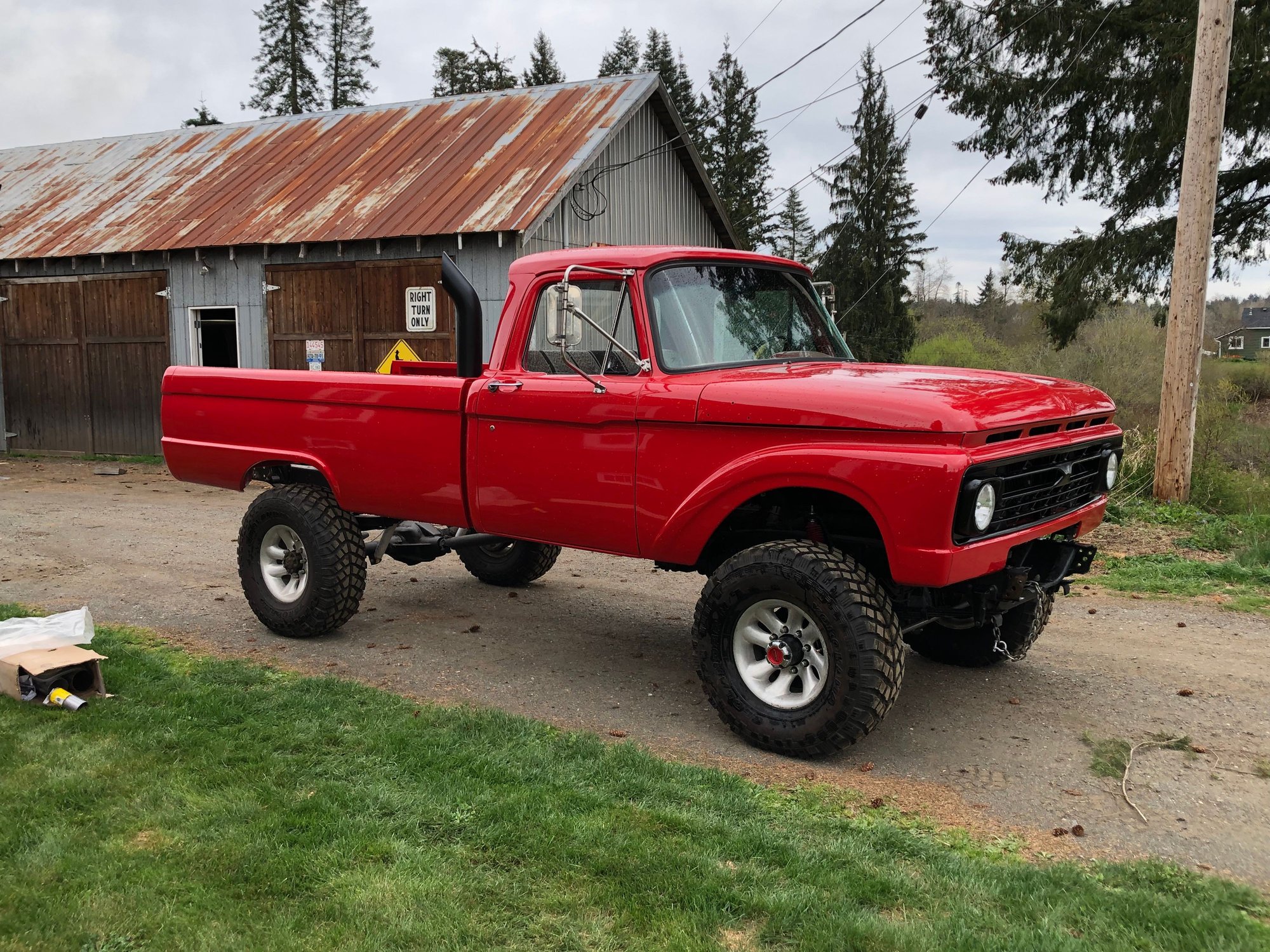

Driver. What do you guys think satin black like the grill or colour matched red. The stack and gauge cluster are also in satin black.

I think the truck should just be sold cheap..... That is a great looking truck!! I would do the Satin black as well. Do you have more pictures

Ya I think I’ve already decided on the black but I was second guessing myself.
