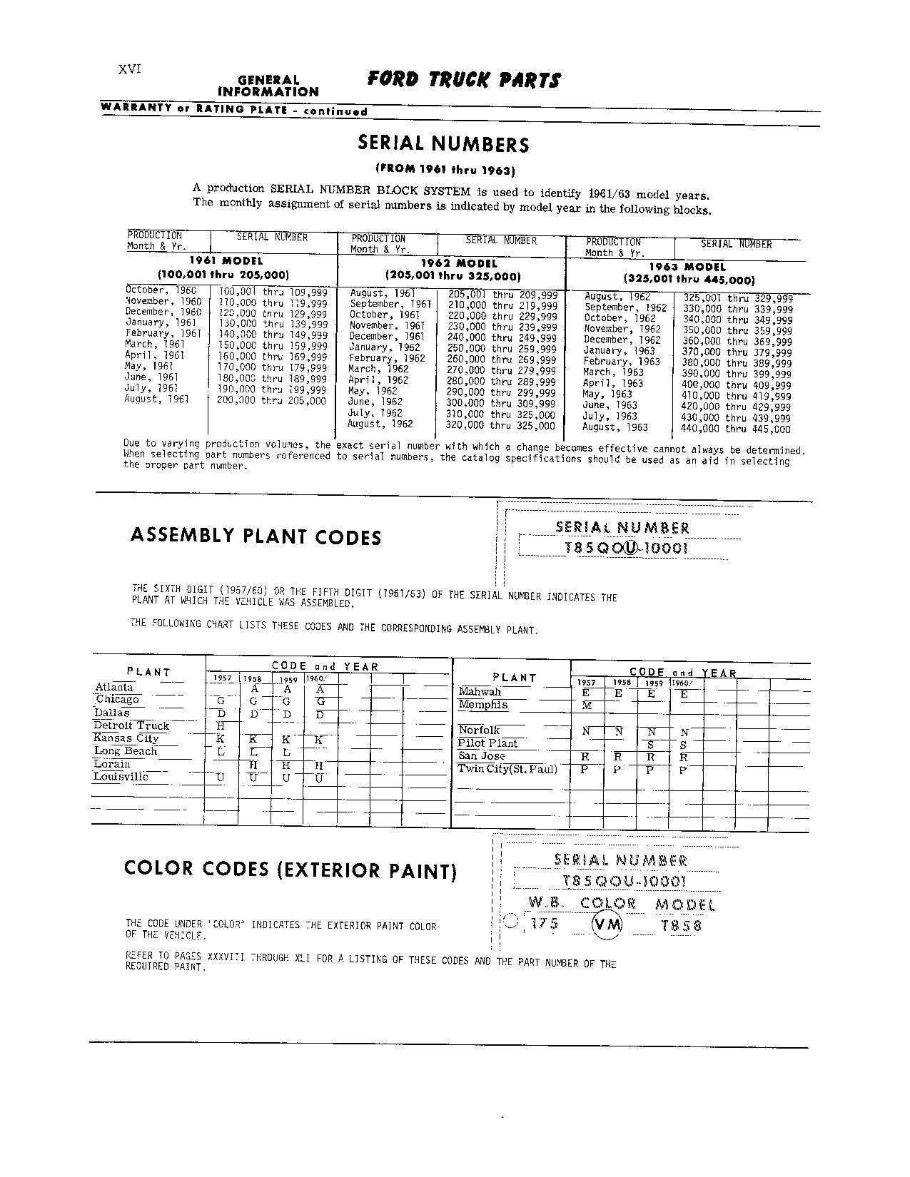

Originally Posted by Bdriven3000
I have a truck. VIN as titled F10JN281039 1951.
Looking at the the VIN tag (Warranty Plate), it looks like a later model tag with the same VIN
This is a 1962 .. not a 1951. Originally the 1961/62 Warranty Plate was riveted to the inside of the glove box door.
The 1961/62 Warranty Plate looks totally different than the 1951 Rating Plate and the codes stamped thereon are also different.
F10 = F100 2WD
J = 223 1V I-6.
N = Norfolk VA Assembly Plant.
281039 = 1962 .. assembled April 1962.
1962 serial number range: 205,001-325,000 (see below):
