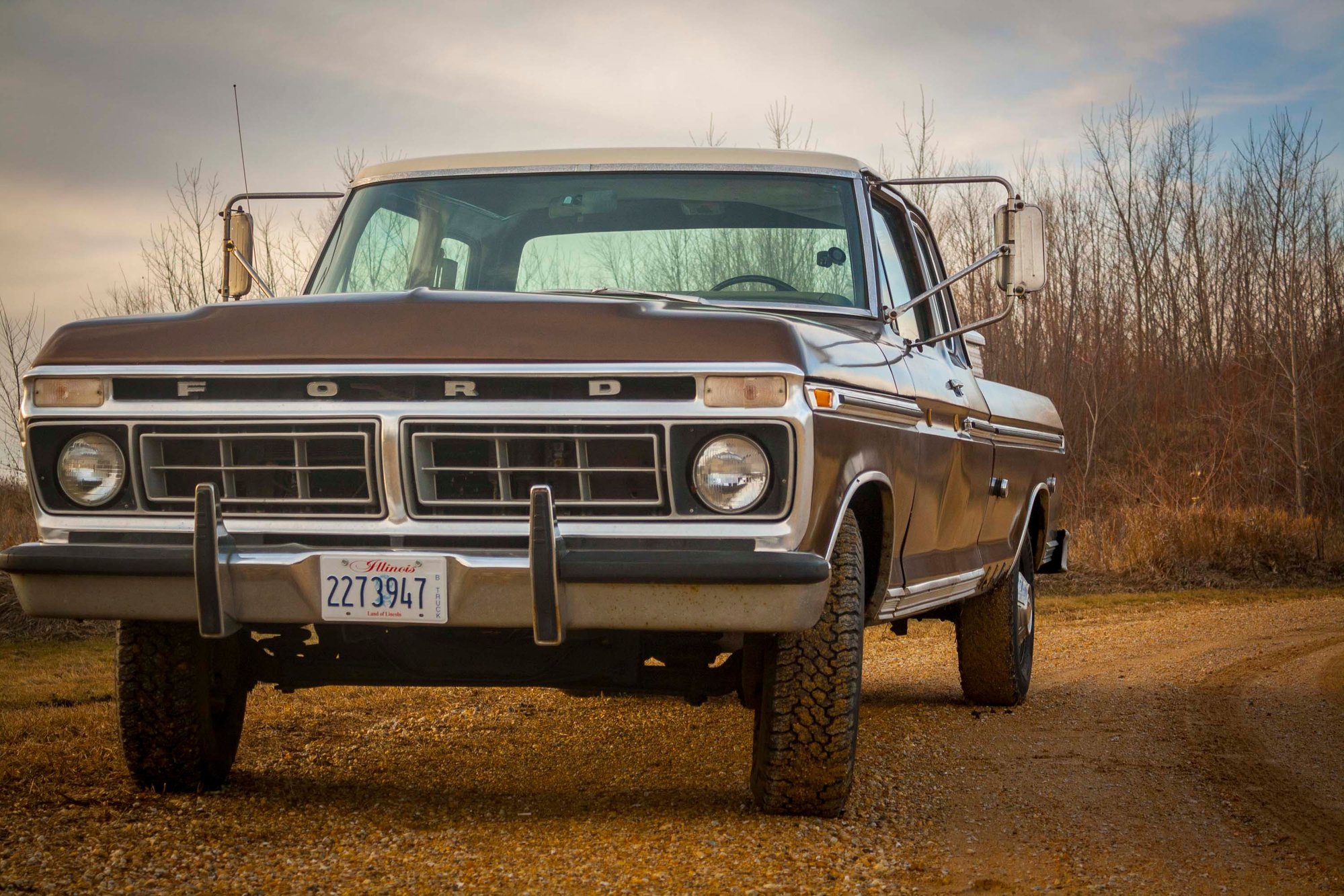

Your a good photographer, the truck looks tough, I like it.
Thanks! Im a college student, I took those photos for a photography class
And if you remove the inner door panel, most of that dent can simply be pushed/knocked out.
