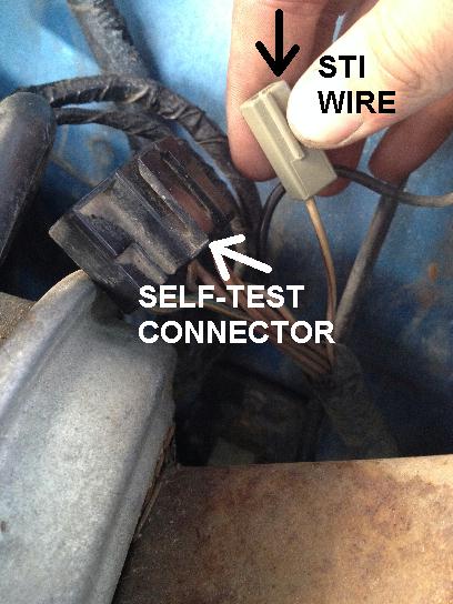

What wires do i jump across to get the cel to flash codes? Been a long time since i fooled with it, the link here does not pull up for me, youtube is all over the place.Thanks

You just ground the STI wire and turn on the key.
Attachment 277905
Attachment 285626

So take the sti wire straight to ground?

Yes, take the sti wire straight to ground and then turn on the key but do not remove the ground until you turn off the key or your stored codes will be lost.
OR
Short the STI wire to pin #2 of the self-test connector and then turn on the key. But again do not remove the ground at pin #2 until you turn off the key or your stored codes will be lost.
