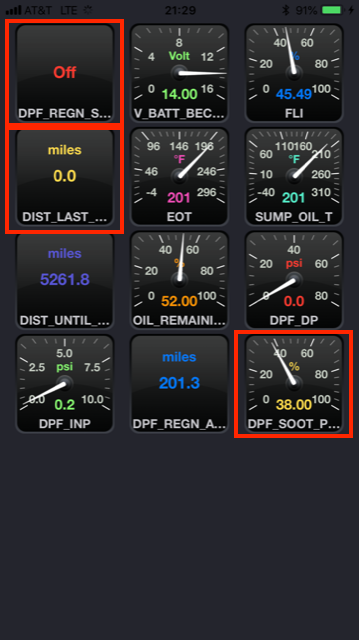

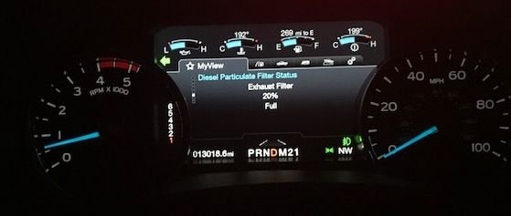

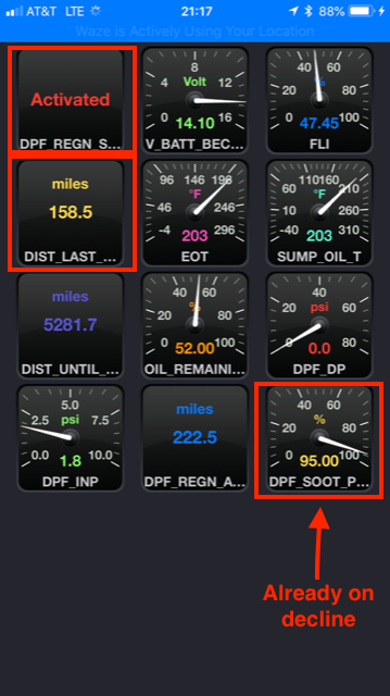

Took some screen shots last night -
ReGen ACTIVATED - 100% Filter full, Mileage since last activation 158 miles (around town (heavy footed) driving
Here you can see the ReGen is complete - but still reports 38% filter full....while the DASH reports 20% full.
2.4 miles later (since last ReGen) you can see % of filter full has continued to decline (even though ReGEN is not activated)....
Dash reports 0% full while ForScan Lite on my iPhone shows 24%
If you look at my Average Milage between ReGen (DPF_Regen_A) you'll see its FALLING.....from 222.5 to 201.3
