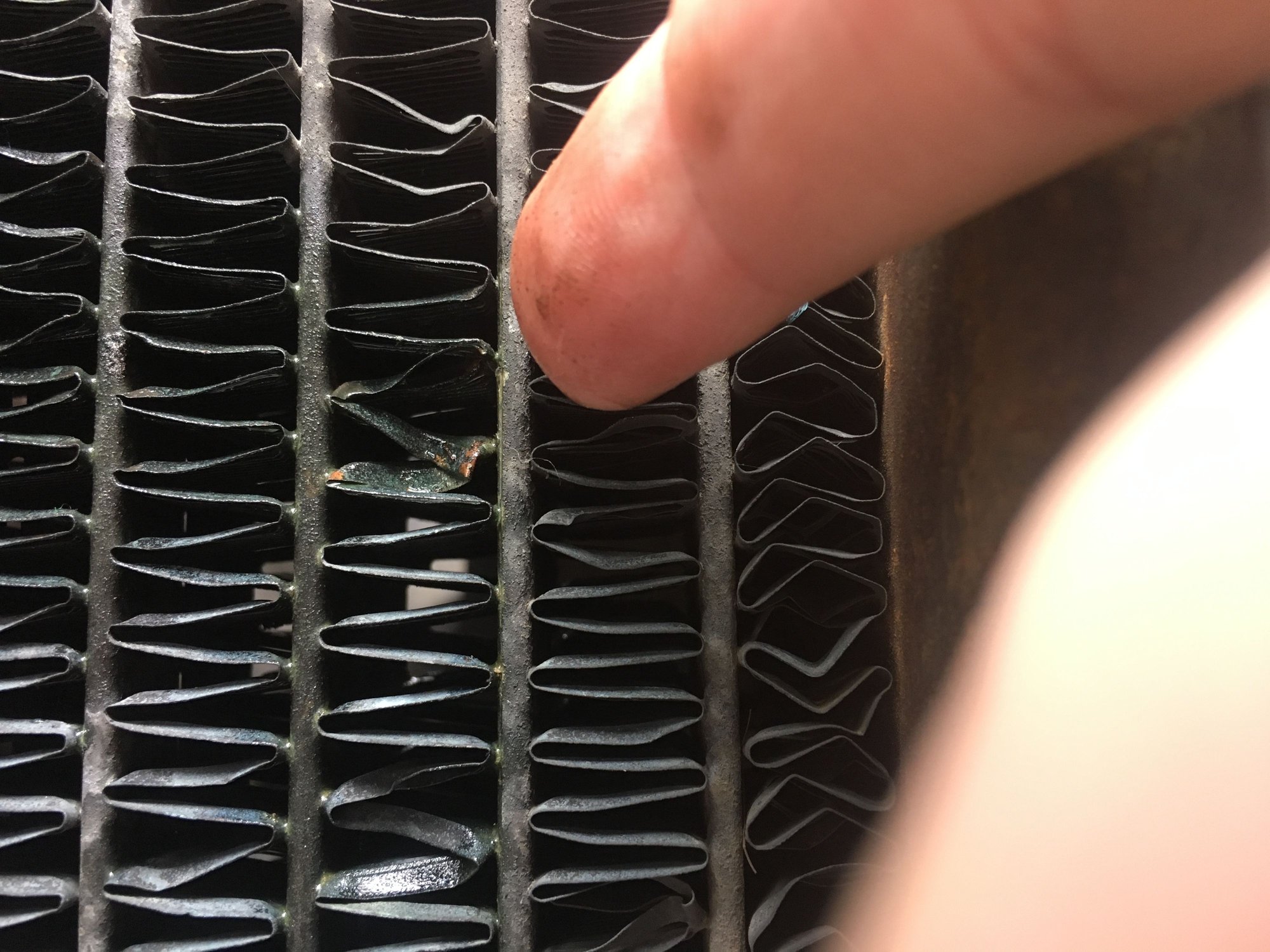

I've got a 1977 F100 2WD 302 manual trans.

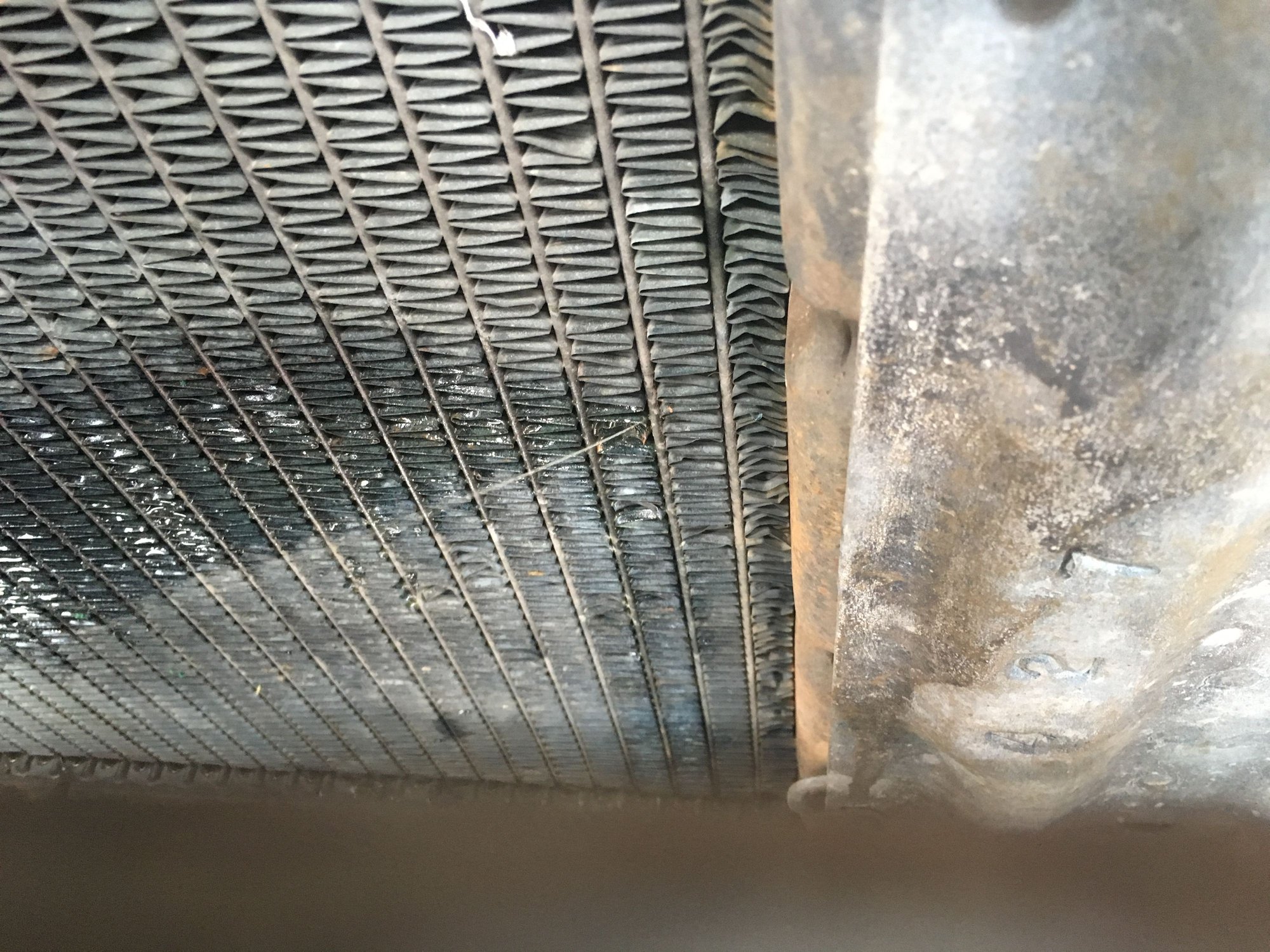

I've got a radiator with a hole in it. See pics.
Is this something a radiator shop could repair? Rockauto has them listed for between $100-$300.
I don't know if this is the original or not but it's not been changed as long as I've had it in 15 years.
The first pic you can see a small stream of spray.

In part it depends on what caused the leak. Was it hit? (possible as the fins look damaged) Or is it corrosion (which may be affecting other tubes as well).
The road side repair is to use needle nose pliers or similar to reach in and pinch off the tube above and below the leak. It is usually best to sever the tube at leak location and roll it up above and below. This will destroy some fins but may still work and stop the leak. If you can clean and pack some epoxy in the hole first this may work better or you or a radiator shop can solder.
The above may get you home or keep her going. Also may be a waste of time if the radiator is basically shot. In that case, the best option is usually replacement. I have had good luck with a Champion aluminum radiator after not so good luck with an "extra cooling" parts store brass/copper radiator.

I take ALL of my radiators to my nearby shop regardless. Costs me around $60-80 depending on the condition. A newly boiled radiator is a world of improvement every time. I've yet to take anything in they could not fix even counting one that caught a fan blade. And they swirl out the filler hole and make the brass all nice and shiny!
Whatever you do, stay away from the aluminum center / plastic sided ones. I've inherited 3 and none were worth a crap. They are un-fixable as well.

I tried to solder it myself tonight. Now I've got 2 leaks. I guess I'll try to take it off and take it down town to a radiator shop and see what they say.

MIne had a small leak and was partly clogged. I had been considering a new one, but didn't want aluminum / plastic. A local shop took it apart, rodded it out, cleaned it up real nice, put it back together and painted it. Dropped some solder on the leaking tube. $189 and it's like new and works great. Always check with a local shop first.

Yeah soldering/brazing radiators is a bit of an art, and a dying one at that.

It never hurts taking it to the radiator shop as others have suggested. I did this and after attempting a repair , they advised it was going to end up costing more than simply replacing. I appreciated this honesty and figured that even if they were to fix it, it was only a matter of time until the 45 y/o copper failed again.
Consider Champion Radiators...

Pinch it off, dry thoroughly with an airgun, JBWeld it. Probably buy you a few years to save up for a real repair.

Took my radiator to a guy downtown. $80 and he soldered it, rodded it and painted it.
Put some water in it tonight for a quick check and tomorrow will drain and replace w/ coolant.
