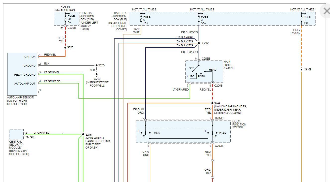

Unplug the autolamp sensor. If the problem stops the sensor is bad. If the problem continues the headlight switch is bad.
