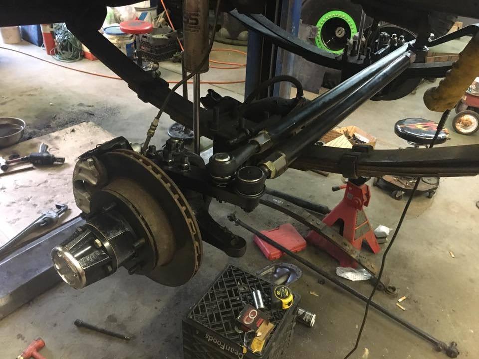

1.5" x.250" wall DOM tubing, Weld-in threaded inserts/bungs, Correct selection of tie-rods. I typically use the GM style tie-rods on all my steering projects for 4x4s, as they're inexpensive and readily available. However the cost will still be around 225+ for the materials and tie-rods. This may also require re-reaming the tapers in your steering arms and pitman arm. Here are some pics of some I've built, first 3 are from my 84 CJ7, full crossover-high steer, Last pic is a 92 Cherokee with Inverted-T style steering. all utilizes above mentioned DOM tubing, and GM "1-ton" tierods (used on K20, K30s)
