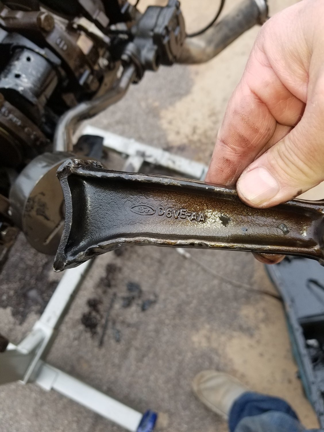

Okay, so Rod caps are date coded C9 and Rods are date coded D9 and are original Ford parts, so does that mean that this was just pieced together. C9 means 1969 and D9 means 1979 right?
The block is D9TE and crank is 3YA.

That engine was twisting 6-6500 rpm when it let go and the oil pump sucked up enough debris to lock it up twisted the oil pump drive quite nicely, 35 years of engine building i have seen this carnage many times and not a one of them was putten along wot.The piston next to the rusty cylinder has 020 stamped on it so engine been rebuilt cheap builder cast pistons.If i was you and wanted to get it going quick and cheap i would purchase a 1978 460 that's on ebay right now 600 plus 220 for the ride and 90 day warranty the sellers name is frenchlakeautoparts it's a junk yard in minnesota.It has the flywheel for c6 on it if your truck has a c6 in it it's plug and play otherwise you will have to get a internally bal flywheel.
