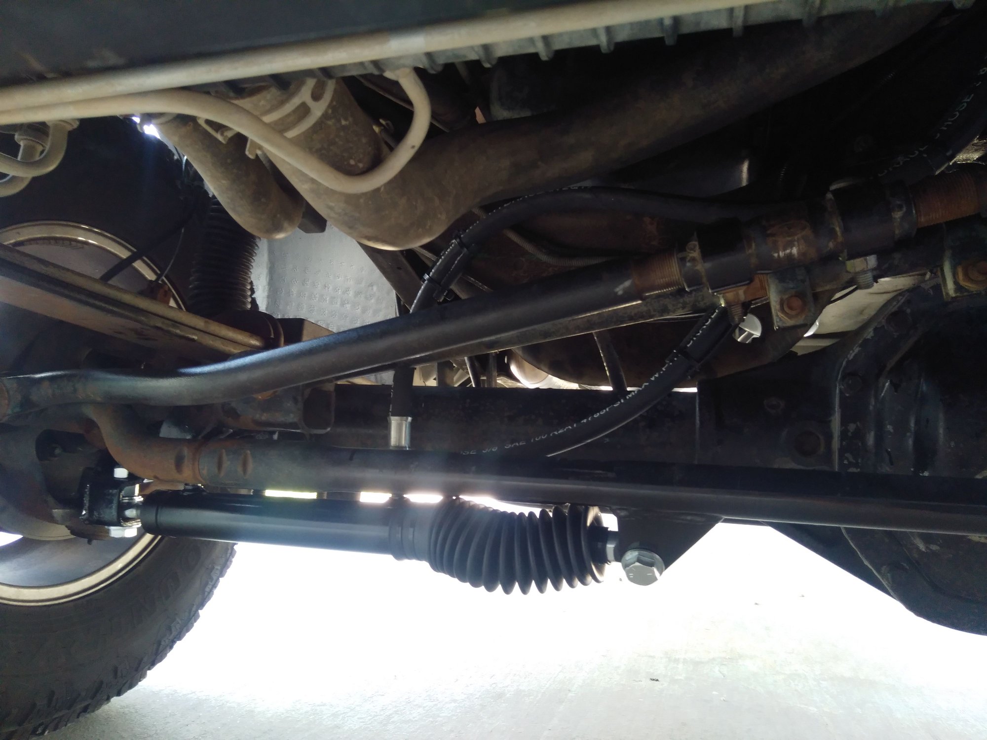

Until something like this happens! Dont get me wrong most of these boxes breaking are with folks running larger tires but I wanted to take ZERO chances with towing. Its nice to know and feel that the ram is doing all the work and the stress on the gear back is gone.
https://www.ford-trucks.com/forums/1...ml#post9783194
https://www.ford-trucks.com/forums/8...l#post12631207

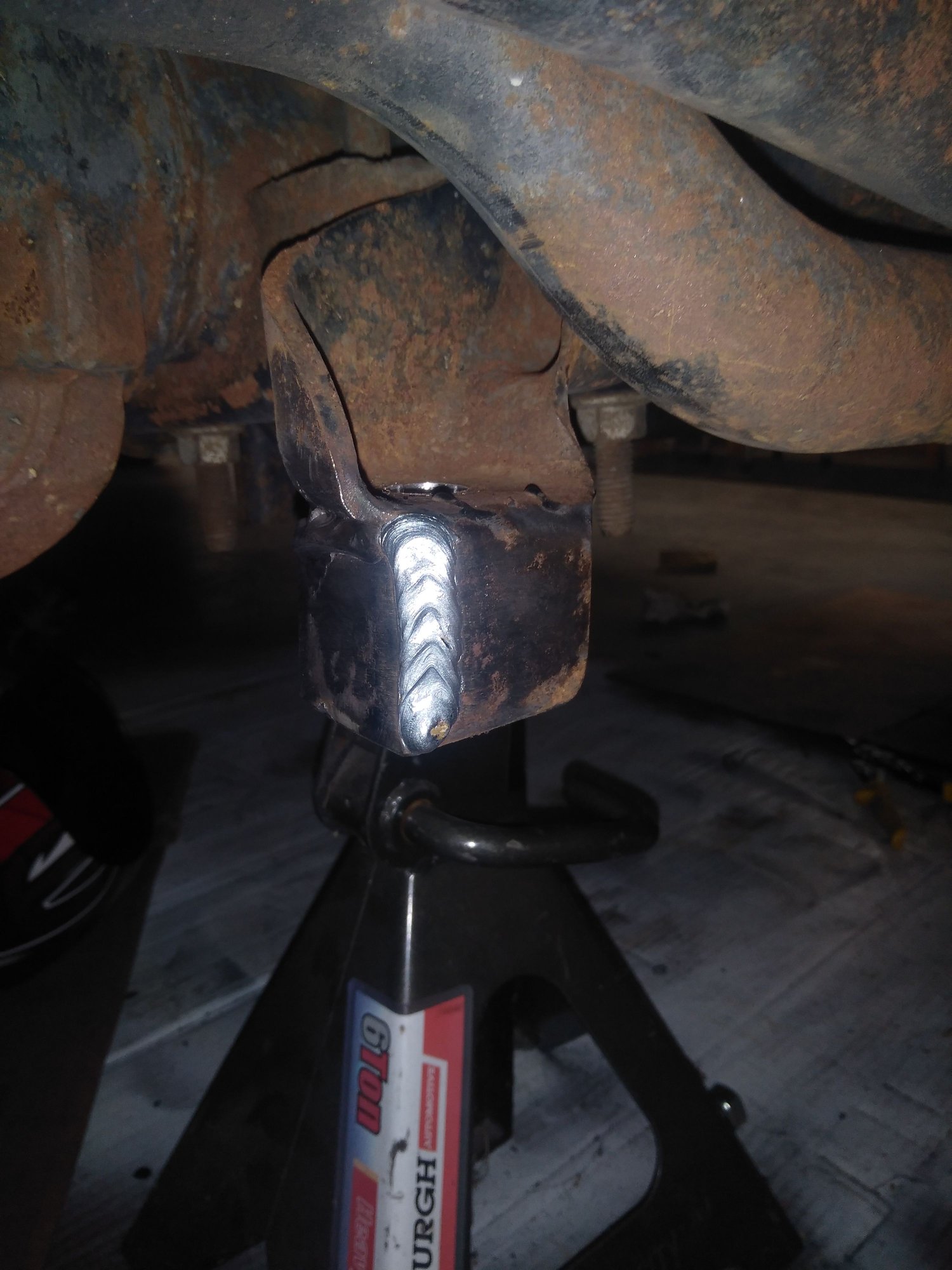

How about this one... "Hold my beer."
On my way to the shop to replace my steering box:

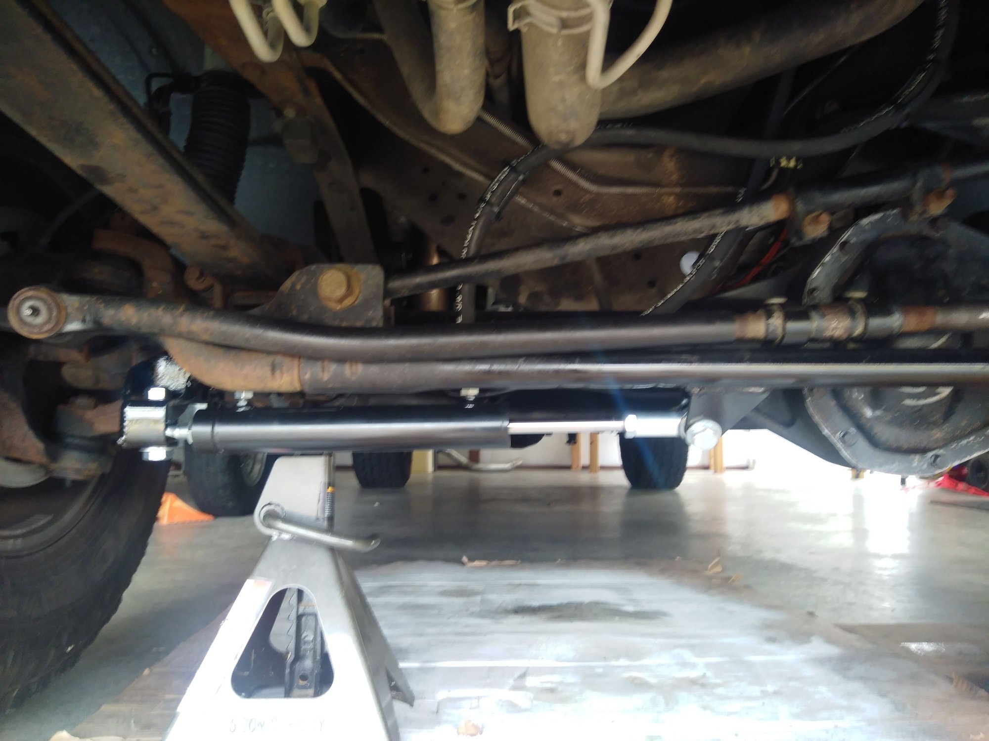

Later that day, after the Redhead steering box was installed:
