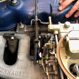

I just installed an Offy 6019DP intake and a set of split exhaust on my 81 F100 with a 300 six. I have a Holley 0-8007 4bbl on top of it. Obviously, the throttle cable needs significant re routing. Before I reinvent the wheel, anyone else done this and can give suggestions on the throttle cable? Thanks, j66b.

Here you can see the Holley 0-8007 mounted on the Offy 6019. The primaries go toward the engine, so the throttle linkage is toward the rear of the vehicle, so you have to put your 1/4in linkage stud into the lower hole on the linkage. The travel of the stock cable and the length are just right, but you have to hold the cable about a foot away and at right angles to the original 1bbl setup.
Here's what I fabricated:
I replaced two of the valve 5/16 coarse cover bolts with 2, 2in set screws. I then found an old wheelbarrow with some stamped steel rear supports, and out of that material made a base, and fitted it to the set screws. I took the existing bracket, milled the slot longer, since it was about 2 in too high, and bent it to accommodate the existing cable. I milled slots in the base to allow for adjustment.
It took me most of a long afternoon to get it right: it's impossible to make measurements for the whole thing: I had to make the base and bolt it in, then set the bracket up and mill the slot to the proper length; then bend it to the proper angle so that the cable was straight; then mark the slots in the base to accommodate the bracket, then remove everything and do the milling, and then put it all back together. Somewhat tedious, but the price was right and it works flawlessly.
I used a 1950's vintage Bridgeport Mill (one of the best tools I ever bought: makes the impossible possible), I TIG welded the base.
I hope this helps others who are faced with this situation. j66b
