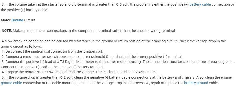

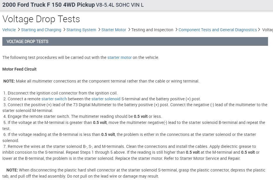

Chad T. Keogh's Avatar
Chad T. Keogh
Joined: Jul 2017
Posts: 278
From: Penticton, BC, Canada
Old Mar 12, 2018 | 11:40 PM
mcdev's Avatar
mcdev
Joined: Jun 2000
Posts: 188
From: Half Moon Bay, CA
Thanks Chad!
That's great info. Hopefully I won't have to deal with this again, but I'm sure it will come up at some point and I know exactly where to look now.
