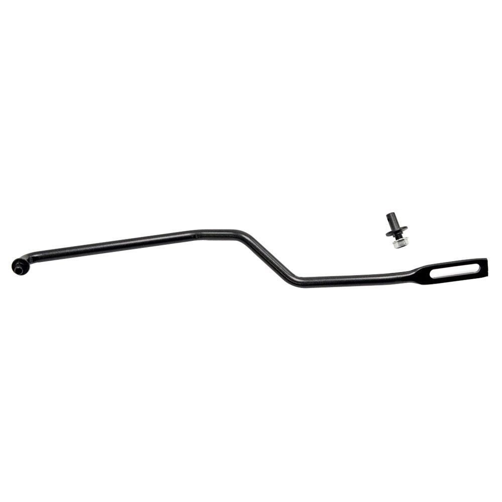

there is a weird bolt that goes in there. Its machined on 2 sides to fit in the slot on the shift linkage, and slips through and pins to the shift arm on the trans. This was the best pic I could find(stolen from ebay) Not sure where you'd buy it separate, but an old school tranny shop might have one in there junk drawer. My only concern is the 2 bolt holes to the left of the kickdown arm, are for a cable shift. That would mean the shift arm is 180 degrees off from where you need it to be. If so, it would be just easier to get a lokar column linkage and start from scratch.
