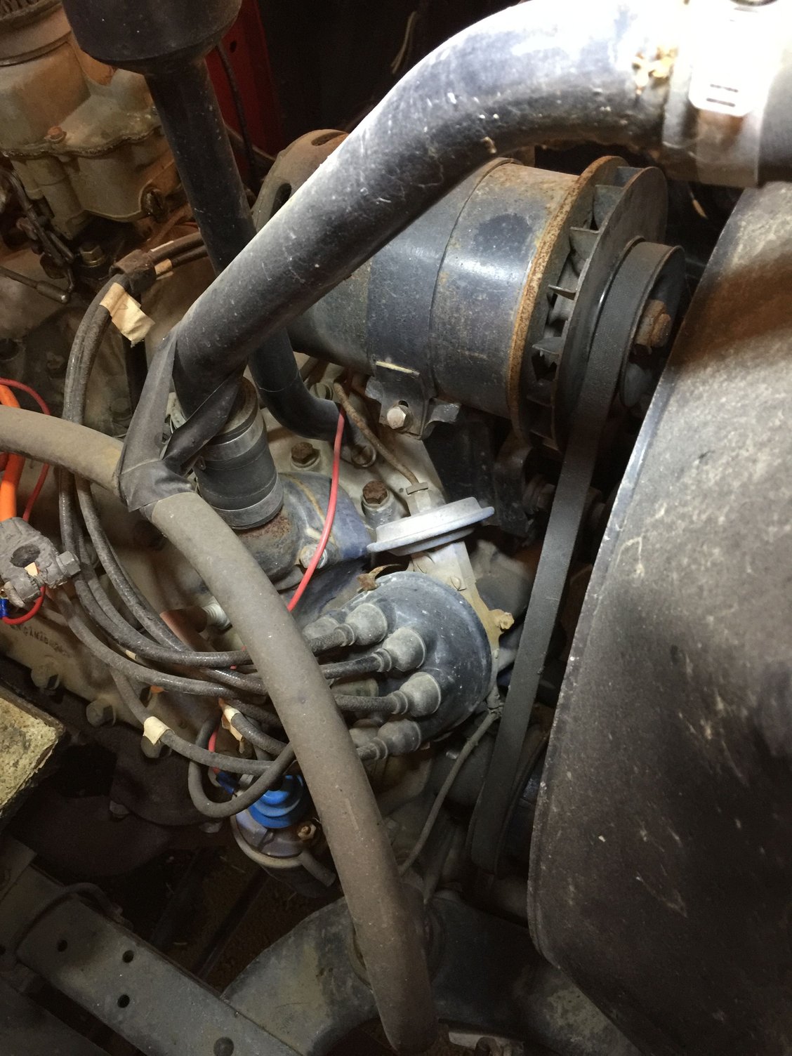

Can you remind us what engine you have, (6 cyl or 8)? Photos of the engine would help.

Sorry I should have included that it was a V8.
Here you go.

The fuel in the glass bowl on the fuel pump looks like root beer! Before you rebuild the carb, you should get the rusty gas tank professionally cleaned and sealed, or just replace it if it's too expensive to restore it. I also recommend replacing the fuel lines at the same time and adding a modern fuel filter.
