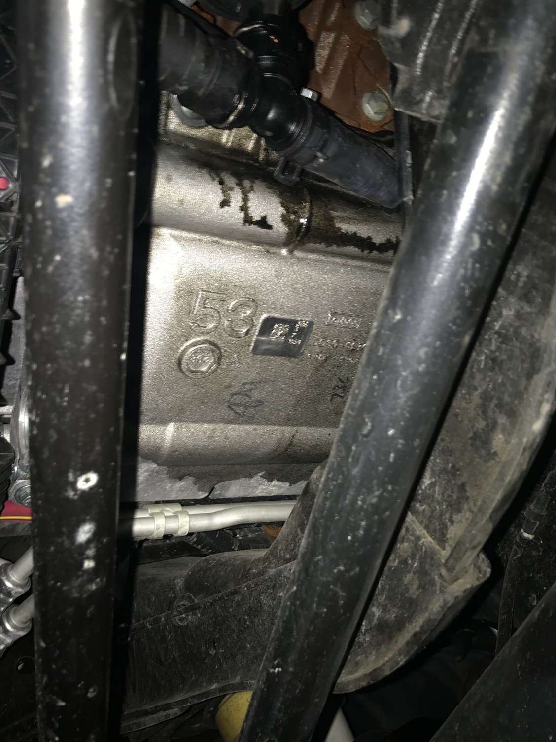

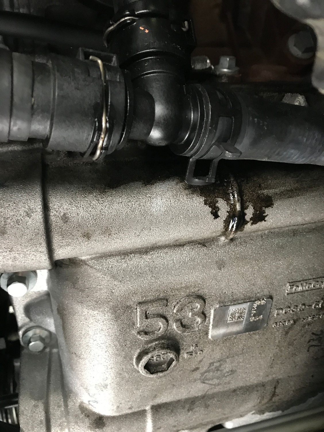

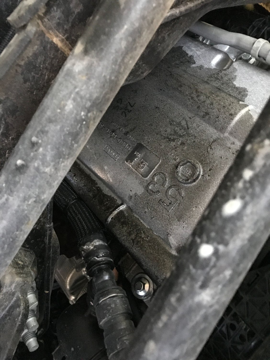

Anyone have something similar going on? It’s not enough to even drip or change the dipstick between intervals but.... it’s bothering me and I do not want to leave it this way. It’s been to one local ford dealer who “can’t find the problem”. So I guess I’ll try a new dealer soon.
Anyone see see anything similar ? Or have it fixed already ?

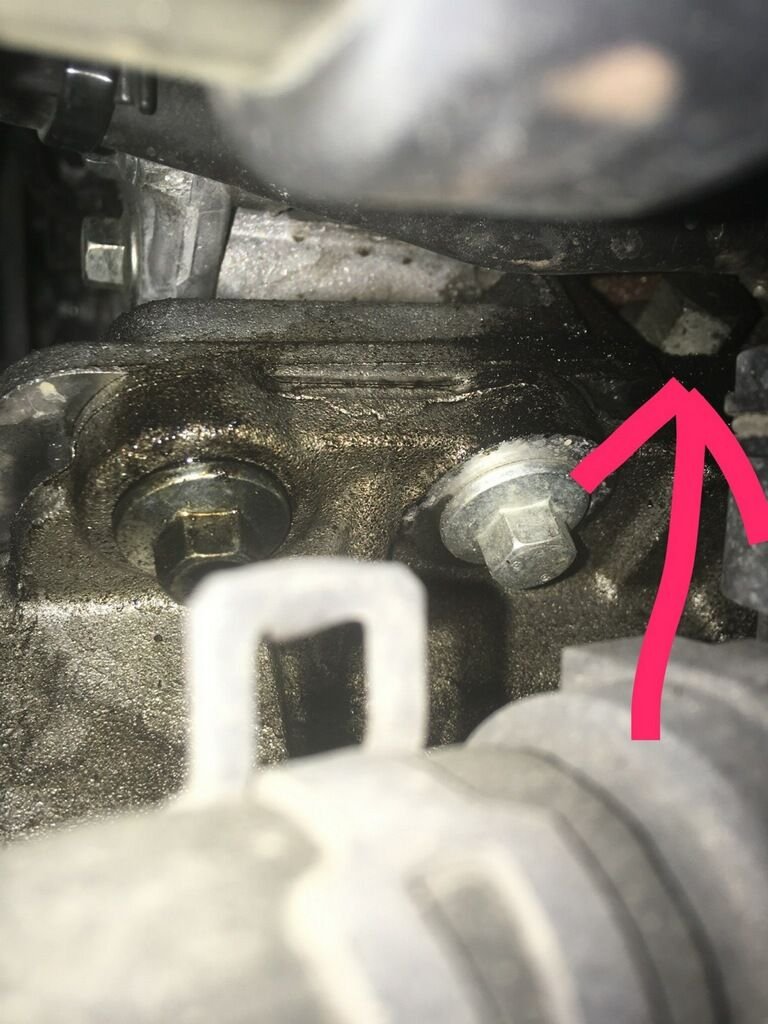

I believe it is coming from the bolt above the arrow, if it is though that would be bad....

Oil leaks are like water and electricity...They take the shortest path to (the) Ground.....Pun intended. Oil leaks can originate from a completly different area then what you can see from below. They are tricky. The other thing oil blows rearward when it enters the path of turbulence so what you see from below may not be where it originates from. I would have the dealer clean the area in question and add a dye to the oil. Take it back in a week and have them look to see where it is originating from. Tracerline is what we used to use. Dye fluoresces yellow-green under both ultraviolet and blue light. Yes, I come the world of dealerships (20 years in the Service Dept). It could be something minor or it could be something that can turn into something major. Good catch and I would have it checked if it were my vehicle.

It would help us (or at least help me) if you told us (me) what and where you're seeing this oil. 6.7L or 6.2L? Port or starboard and forward or aft? Inquiring minds want to know.

6.7 and it’s towards the upper part of the pan hard to explain have to compare photo to actual honestly to find that spot

Bolt 1 or Bolt 6 is the suspect and the bolt in my above photos

Anyone know if those can be tightened and or how they are sealed?

Upper oil pan is sealed with RTV.

I think it’s the bolt above the upper oil pan bolts (one of the block bolts)
You think one of the horizontal main cap bolts are leaking? Could be a possibility.

Correct I do or something in that area above it only because the oil is thickest and blackest there
