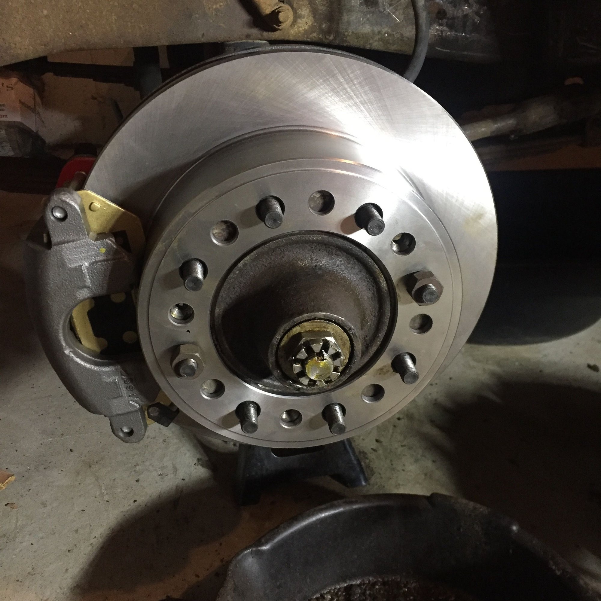

Im using 17.5 ford wheels (not widow makers) on my coe..
They clear 3/4 ton gm disc brakes.
Im going with cockers (sp) 17.5 tires and ford center caps.

The SRW 17.5” will clear the early 14” rear drums. I’ve had them and have seen that they fit. This solution I think was also discussed in one of the two old threads I linked above. The benefits are many, and the only drawback is the shorter tire diameter of the 8-17.5” tires. The stock 7.50-17” is 34” tall while the 8-17.5” is 31”. The tubeless .5” tires are constructed with shorter side walls which explains the difference. Stu
