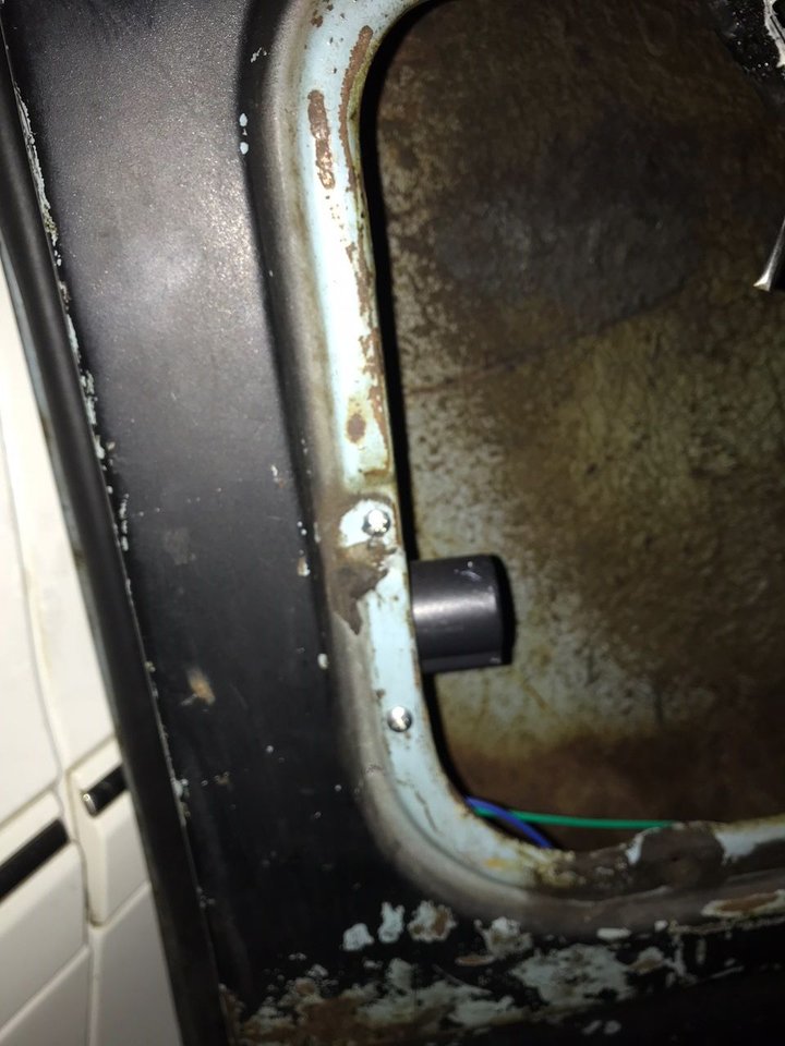

Just some pictures (crappy) of where I placed the actuator....

cal1319, thanks for sharing your "net" find and the pics. I'll let you know if I need help with the wiring, I'll see when the stuff gets here.
