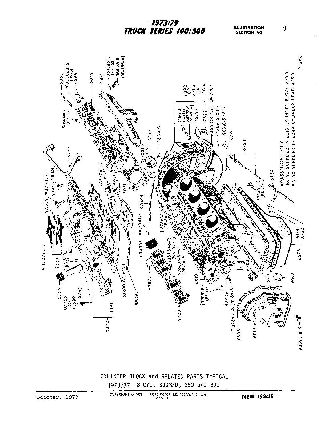

Originally Posted by F-adams
Nope, that's a Valley gasket on a 351-400M. I am referring to the heat shield mounted to the underside of the manifold on an FE block. .
C5AZ-6A630-A .. FE Intake Manifold Oil Baffle (upper in pic) / Obsolete ~ 0 available NOS
1965/71 Passenger Cars / 1965/76 F100/350.
B9AZ-6A630-C .. FE Push Rod Crankcase Vent Baffle (lower in pic) - 19 7/8" long x 10 27/64" high / Obsolete ~ 5 available NOS
1959/71 Passenger Cars / 1965/76 F100/350.
.Pic: Both shown as 6A630:
