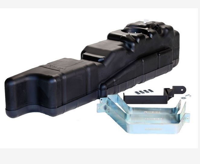

Here are some screen captures of the Titan tanks.
The first one is LWB and you can see strap placements. The photo cuts off the rear part of the tank but does show all 3 straps. The left two are in the stock location. The front strap is added to support the front of the tank. Maybe not needed with a stock 37 gallon tank in a SWB.
The other two photos will give you an idea of the top of a SWB tank vs top of a LWB tank.

Titan 50
Larry -- Nice info and photos. Had a Titan 50 gallon diesel fuel tank installed (4 Wheel Parts) to replace the original 26 gallon. My local Ford dealer reprogrammed the trip computer (to correctly compute distance to empty, etc) for free. Looking forward to the doubled range, especially when towing.
