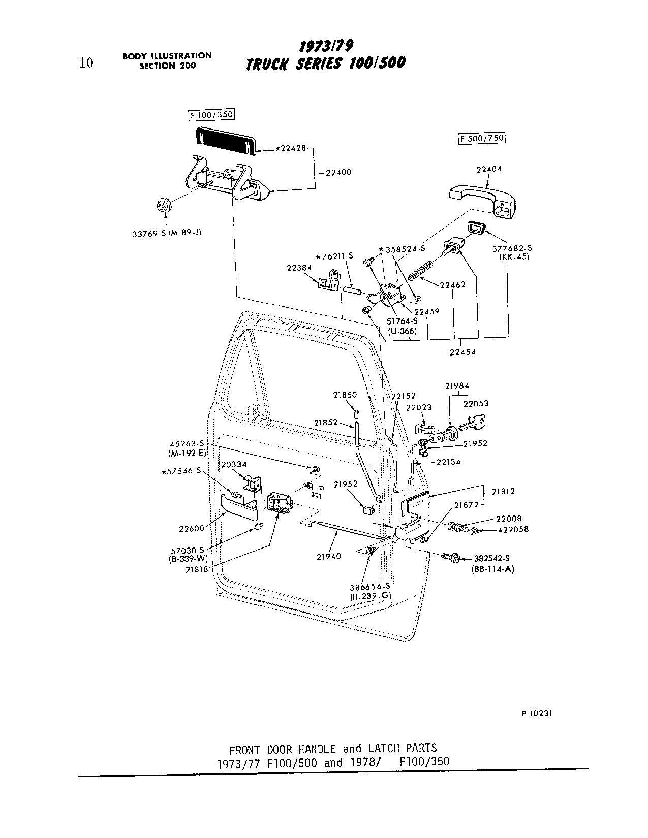

Likes: 5,811
You mean the door lock right? Part # 21952?
File Type: pdf
Old Jan 29, 2018 | 08:07 AM
N2S3's Avatar
N2S3
Joined: Nov 2016
Posts: 106
yes 21952, thats the part.
