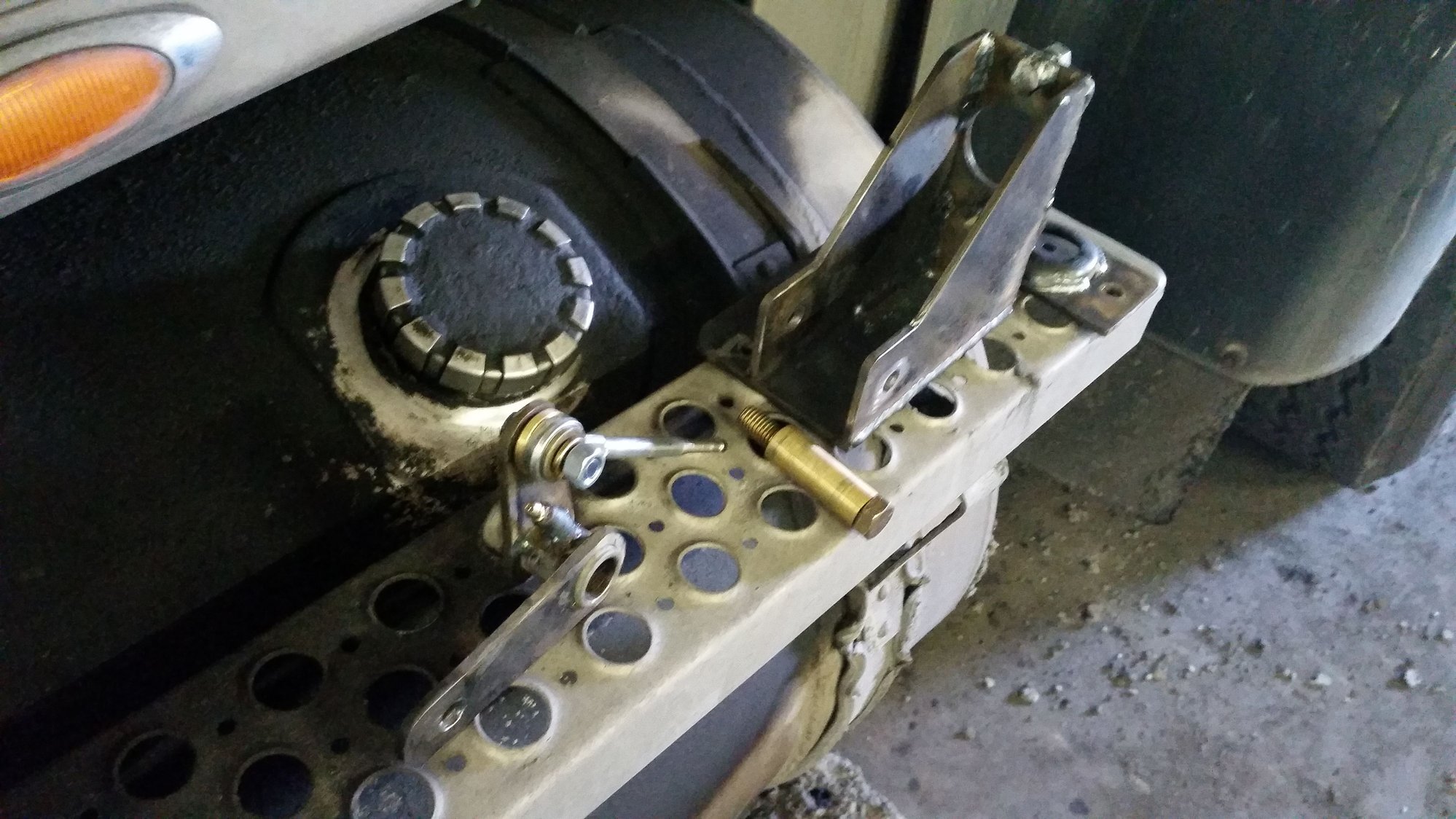

If you do the ZF5 though and need a master cylinder for the clutch, you could mount it to the frame. That is what I had to do when I swapped my FE for a cummins. I needed a hydraulic clutch for the Dodge Cummins bellhousing. I made a bracket off the frame that connected to the linkage coming out of the bottom of the cab and then connected to the master. It took a bit of time to figure out the correct swing, but does work pretty good now

Its kind of a crappy pic, but if you look close you can see the bracket and then the reservoir is mounted off the side of the master cylinder.
