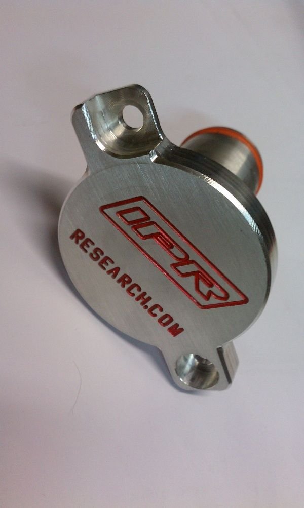

https://www.iprresearch.com/IPR-EGR-...nal-VT365.html
If you leave the EGR valve plugged in, this will act as a "delete" without removing the cooler. Leaving the OEM valve in place unplugged doesn't address the ruptured cooler concern since fluid will still pass the valve, which can be forced open by exhaust back pressure. This plug seals with rings and will do a better job mitigating a blown cooler, although if you see coolant in the exhaust you need to dig in FAST.
This is a slick device! I bought the coolant filter from IPR. After Vince replaced the manual shut off valves for free, it works great. Keeps my coolant clean and it's easy to service.
Doe this EGR bypass accomplish the same thing as the IPR research plug?
The IPR bypass plug has a real "plug" The other unit is a plate.
Ford 6.0 EGR byplass plate
I can pick one up on eBay for $10.
