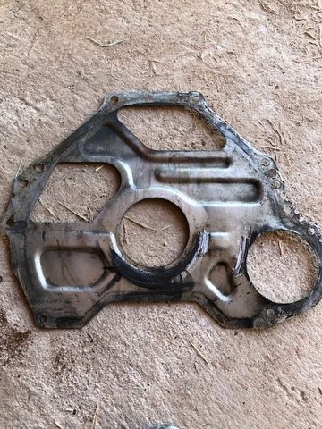

I dropped the transmission on my 77 f100 to change out the flywheel that was 28oz on a 1987 block with a 50oz balancer. When I pulled the flywheel I saw the following separator plate. Given the thrashing, I don't think this plate is made for this application. I found another post that says I need a D0AZ-7007-C plate along with some interchange parts(link).
Does anyone know if this one from summit will work? It does say it is for a 164 tooth flywheel which mine is. https://www.summitracing.com/parts/sdk-c9dz-7007-a
Also, does anyone know what the one in the pictures is for?

As far as I know the first letters D8 stand for 1978 for the one in your picture and looks very similar to the one in my 79 f100 with 302 ,

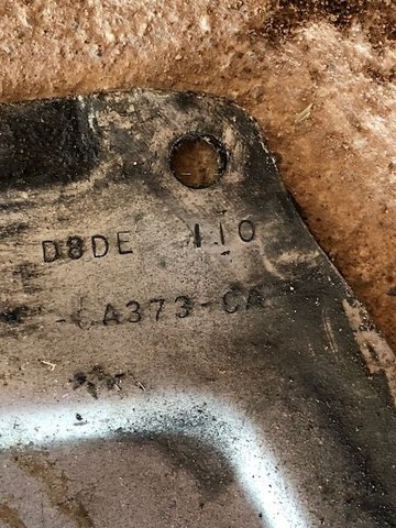

I can see the ID engineering number prefix of D8DE, but not the rest of the number.
There are two different part numbers:
D8DZ-7007-A .. Engine Rear Cover Plate-Use with A/T
1979 F100/150 302 & Econoline 302/351W / 1978/80 Granada 250/302; 1979 Fairmont/Zephyr/Mustang/Capri 302; 1979 LTD II (not an LTD!)/Thunderbird/Cougar/Ranchero 302/351W
D8DZ-7007-B ..Engine Rear Cover Plate-Use with M/T
1978/80 Granada/Monarch 250/302.

I can see the ID engineering number prefix of DE, but not the rest of the number.
I see DE-6A373-CA
I see D8DE-6A373-CA
When you quote posts that have 8D typed together, or you type 8D .. you have to disable smilies in text (as I did), otherwise you get that smilie face.
Pick out one of the two part numbers that I typed that fit the criteria.
