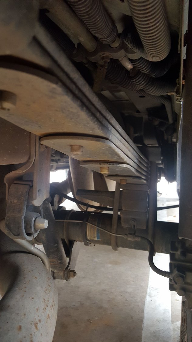

2004 Limited 4x4 6.0.
Want to identify rear springs.

I know the suspension in front has been modified. There are 3 leafs as opposed to 2. Uncertain on rear.

That appears to be a stock rear leaf. Measurement from middle of wheel to the top of the fender well?

24 1/2 front
24 1/8 rear

That is a stock rear measurement. Stock on front would be 22.5-23"

Hooked, your EX should have DG under the "SPR" on the door sticker, all PSD EXs came with D code front springs (I know yours are modded) and ALL EXs came with rear G code springs, which it appears that you still have.
