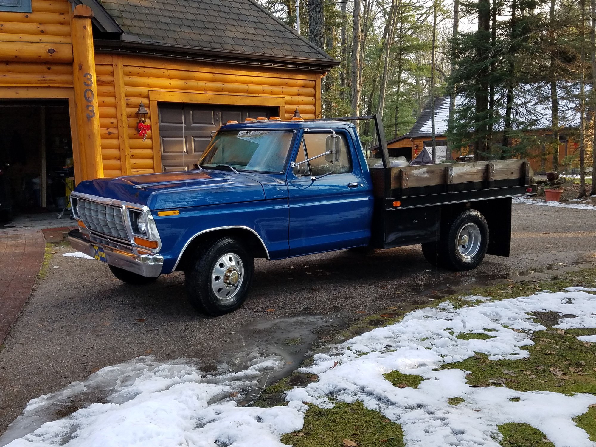

I agree with 79Ford on the alignment issue. I built my own to factory spec cab n chassis size but used 1/8th" channel iron and added more x members in case i decided to add a hoist and used 1/4" flat stock and scribed it to 1/2" clearance to close the ugly gap between bed rails and frame.
I'd try to take a pic of one you like and use it as an example for yours, i did that from a few dump trailers to gather the best ideas for one i custom built for my needs.This my 78' just after completing the bed and also with 4" channel side rails (bolted on) with stake pockets in case i needed it flat for some reason.
Good Luck and enjoy the build...i did.
Bought in 5/82 and used 5 yrs. summers only, been setting mostly until now. Only mods have been bed, wheels, tires, engine professionally rebuilt and stroked to a 400, Flowmaster 1 in 2 out with side exhaust, not much at taking pics to date but will take more as i progress. Just installed new bed I'm building from specs of original just heavier steel in case i want to make dump. The other pic is just before putting in the distant garage for additional mods.
Nov.2016 before putting in garage to make improvements ie; Change grill to a 77', paint engine remove cab, paint frame, install all new cab mounts & bushings, insulate cab, undercoat, new sound system, running boards ?, possible rear disc brakes, trick out engine & repaint cab.

Also, it has a diamond plate deck with HD tie downs spaced at 50" across (plywood) and bolted through cross members as well as a HD hitch.

I think it is Very nice ….If it was me I would have left it aluminium.....with a nice ladder rack extension …….some side Tool Boxes …. I know how expensive it is …..just my preference....sweet Truck ….I have a 77 Dump 350 in my sig. the thing is wild …..smokes the duallys … I modified the engine and Intake / exhaust mods as well ….Unfortunately we have Salt up here in Winter so you need to stay on top of your body....I need a front clip.....
