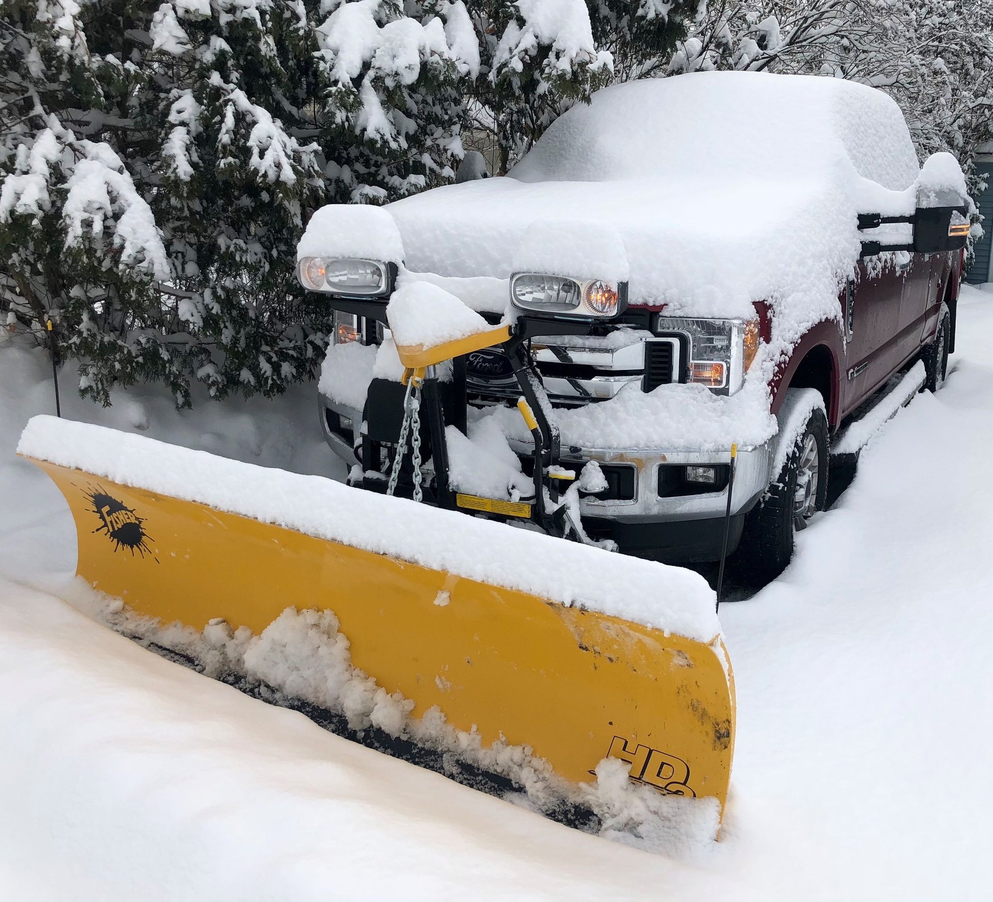

Christmas morning in NH a few days ago. Not a terribly large storm by any means, but a fair part of the day spent cleaning up. Woke up this morning to -20F. Truck was plugged in all night and started well to take me to work. Anti-gel additive is in the tank for sure. We're expecting this type of frigid weather through next Wednesday or Thursday. The sun is out, but it's currently -5F. I'm very glad these trucks are well suited for all conditions as well!
