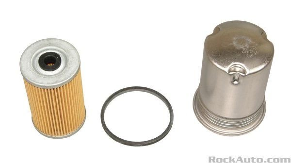

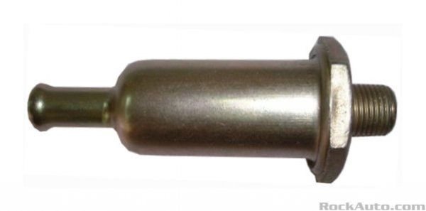

You can disconnect the line from the fuel pump to the carburetor to check the flow. The service manual says that it should deliver 1 pint in 20 seconds. If it doesn't it could be a bad pump, a congested filter, or an air leak in a rubber hose or connection further back toward the tank.
You can test the carburetor filter by removing it and blowing through it. If it's clean there will be little resistance. If there is resistance replace it. If your pump filter looks like this:
And your carburetor filter looks like this:
You can buy them at Rock Auto for about $10 or so.
But what you are thinking is fuel starvation could be something else. Try to do adequate troubleshooting before replacing good parts and doing a lot of work that isn't needed.
