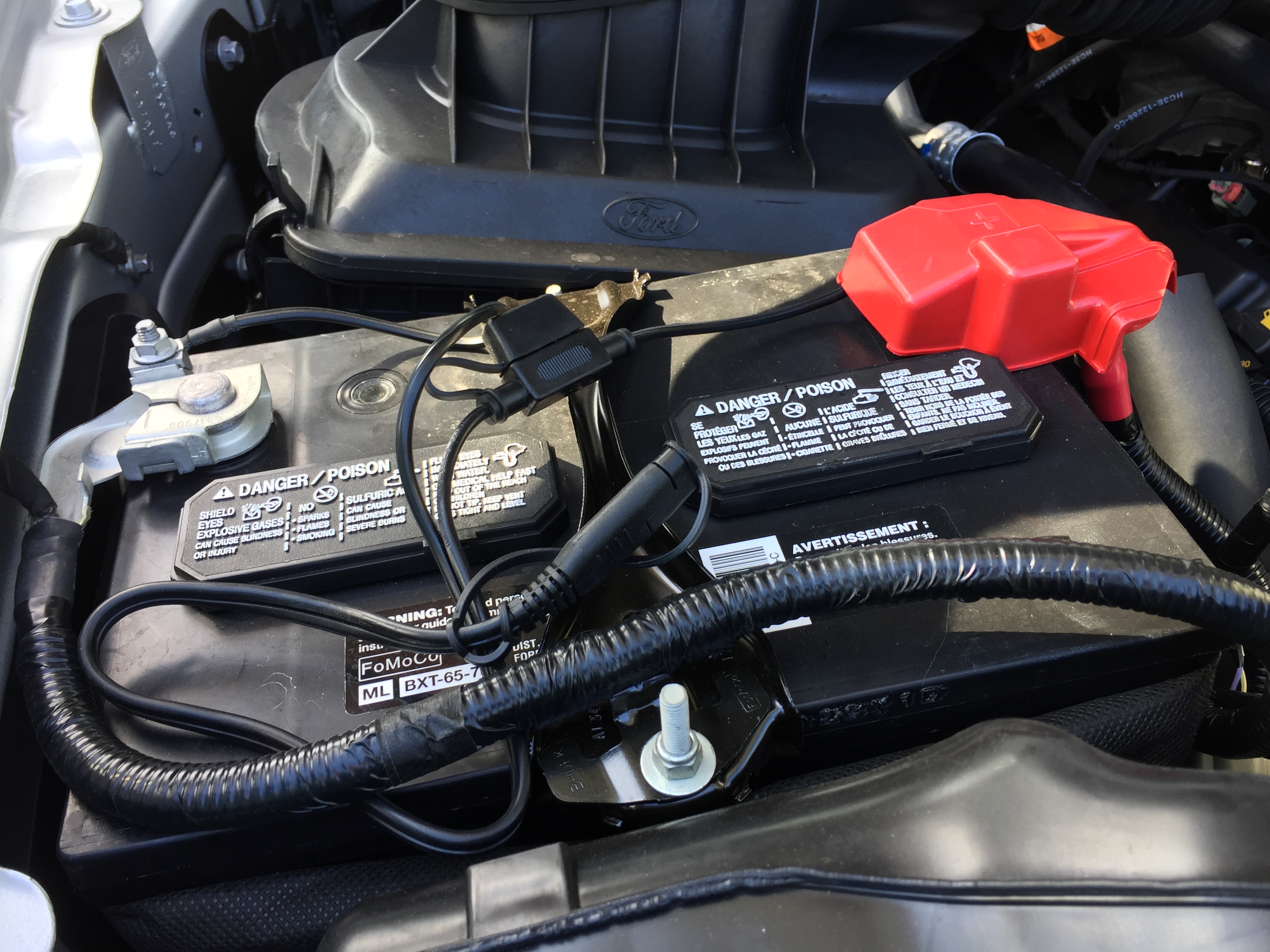

When I get back to the states and pick up a new truck, I think I'm going to install a charger pig tail on my battery terminals for quick hook-up like I did on my previous Harleys...........I know it'll do my truck batteries well during extreme cold (overnight charge) or longer periods of inactivity.......
That's what I did. Use the BatteryMinder 1500. Keeps both batteries ready to go.
Yup, that'll do it.

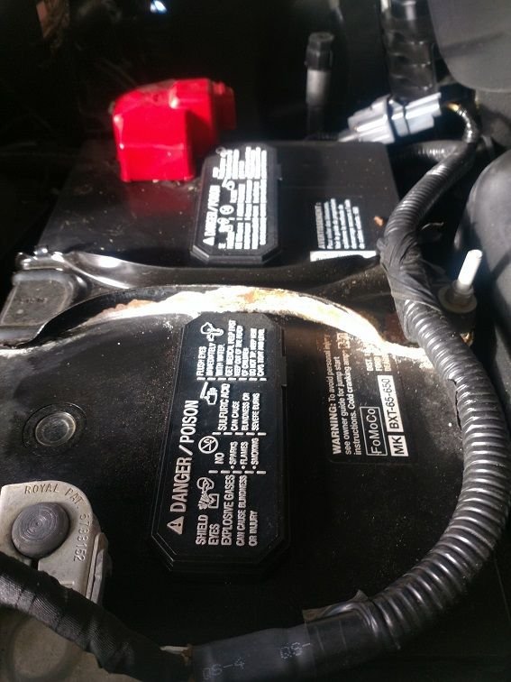

The first time I've ever had an issue like this on a new Ford. :
It's leaking pretty good.
I was helping my FIL hook up his boostmax on his '15 2.7 f150. I noticed his battery has motorcraft and AMG on it, and looks a bit different than any other battery I've seen in a ford truck. I'm guessing it's a pretty high dollar battery, as his truck is equipped with that auto start/stop.
Had same problem on my '15. A slow leak started at ~18 months that got worse over time. After about 6 more months, I finally got tired of cleaning off the corrosion, and made time to take it in to dealer.
I was thinking that something was wrong with Alternator/Voltage Regulator and it was overcharging/cooking the battery. To my surprise the Jr Tech came back and said that my charging system tested fine under load. He then tried to say that the battery hookup for my aftermarket stereo amplifiers was the problem and "was causing the Battery to overcharge." Huh?
I asked if we could talk about his diagnosis with the Service Manager. The manager raised his eyebrows at the Tech's story, and then turned to me and said that they would fix the problem. A few minutes later, I had a new Service Tech and within 30 minutes the battery was replaced. One cell was bad, not taking a charge, and the rest were overcharging. They re-ran the charging system tests and gave me the print outs as proof that things were fine. No charge, it was all under warranty.
Service Manager said they got Motorcraft Battery problems in spurts. There'd be almost nothing for a month, and then they'd get 10 vehicles with leaky batteries in a week.

the caps are vents... a wet battery MUST vent...
but a not 100 percent correct battery will over-vent.. and then the poor paint job on the support bracket..
and you end up with that photo...

I guess I'm gonna pop my caps off and suck some acid out because my hold down is starting to rust on the corners. I've wiped off the top of the battery a few times since I've owned the truck the last two years.

Alright well nevermind....popped off the caps and the battery certainly does not look overfilled so I have no idea.
Pics of the sacrificial hold down
