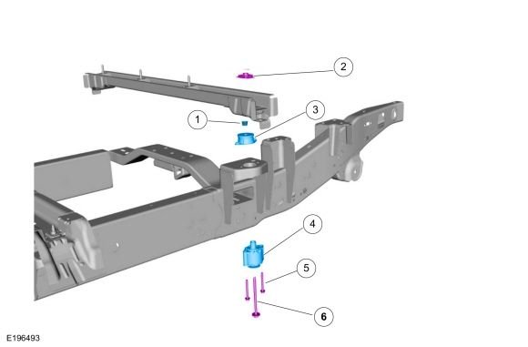

Originally Posted by tony m 6.7
Wow, I wasn't aware that the rear shock hardware is disposable and not recommended for re-use. Is that the same for the front shocks also? (Since we're getting use out of your shop manual) Thanks!
Sorry, just saw your request. Yes, it is.

Originally Posted by colsoncj
Do you have the torque specs for the bed bolts and the rear cab mount bolts?
  • Bed Bolts - 129 lb-ft (175 Nm)
  • Body Mount Bolts - Center Lg Bolt 76 lb-ft (103 Nm), Two Smaller Bolts 46 lb-ft (63 Nm)
