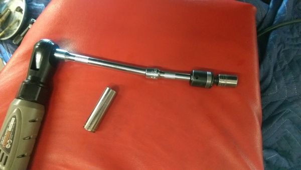

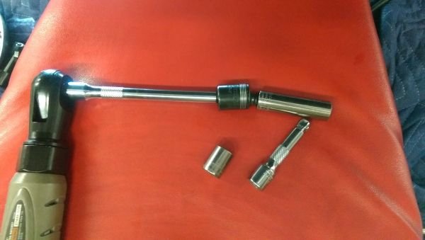

UVCH bolt removal tool setup
UVCH bolt removal tool setup. Always difficult to find the right combination of tools for the difficult bolts
NINE MINUTES to remove passenger UVCH (CAC tube removed and MAP sensor loose, A/C pump bolts out and slid forward already). Includes the oil dipstick tube and bracket
I wasn't trying to cheat the time, this is where it was when I was reassembling and ran into a snag and had to remove it again.
First pic is of all the tall access areas. The second is for the really TIGHT rear bolts against the HVAC and firewall areas.
A third combination is simply a shorter main extension (if needed) for the top rear bolts under the windshield for clearance.
Wobble extensions and spring loaded impact universal 3/8" drive, cordless ratchet from Harbor Freight.
It's important to get your fingers down in the back to hold that socket in place on the bolt heads. The universal seems to be just right to get the angle to fit on straight but not too much to bind or hit the sides.
The deep well moves the pivot point up too high, even a universal there jams against the sides. The Excursion clearance back there is very tight!
The double wobble extensions setup seems to give just enough bend to the setup to fit the ratchet into the right spot.
