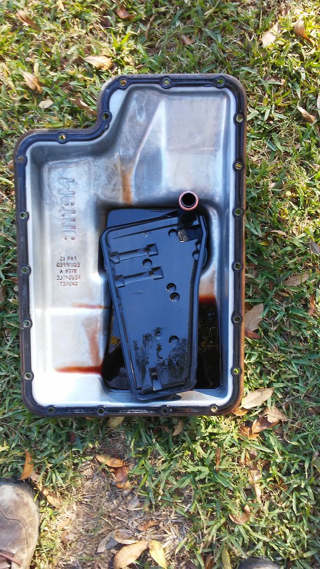

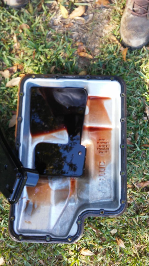

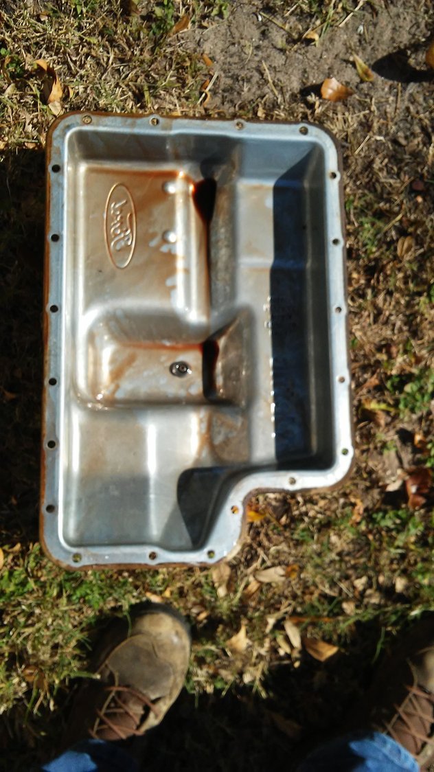

Old Nov 27, 2017 | 03:50 PM
Lawnpro979's Avatar
Lawnpro979
Joined: Nov 2017
Posts: 337
From: Bellville TX.
It was very clean. No metal shavings......250,000 miles on truck. It prob had 100,000 plus on this change
it didn’t have the magnet in the pan and it did have a drain plug.
I wont know anything until tomorrow when i try to drive it....
i also drained the Torque Converter.....
thanks
