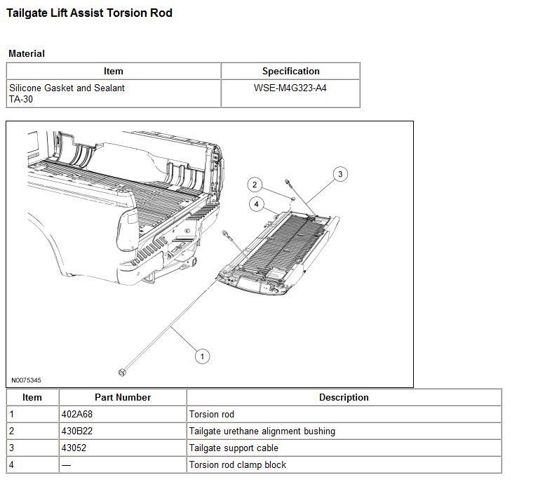

Just for grins I checked the book for the 2015 and the part numbers are the same as Larry posted.
Called my parts dealer in Iowa and he gave me the following:
402A68: $88.82
430B22: $25.95
43052: $25.10
I have looked at the DeeZee and other offerings...I personally just don't like the looks of external stuff-especially in an area the could see a errant impact every now and then. I really like the setup Ford has for the F150s...

There are some photos of the parts in the FL3Z-99406A10-A kit on this eBay link. The photos might assist in determining if it can fit or be made to fit. It appears the "shock" is hidden behind the tail light.
https://www.ebay.com/itm/OEM-FL3Z-99...RZSnca&vxp=mtr
You do not have the full part numbers for the Ford Assist?

Working on it now...I think the biggest hurdle to cross will be the weight damping feature...the F150s are aluminum...
Going to pull my tailgate and get a weight on it...then calculate the moments of inertia and the 1 deg points of the 89 degree swing...
Thinking that the tailgate weight would preclude a piston damper-then there is the size limitation to keep it tucked neatly behind the taillight. The piston would have to be huge though-there is a lot of space behind the taillight....maybe a rotary damper would be better suited.
