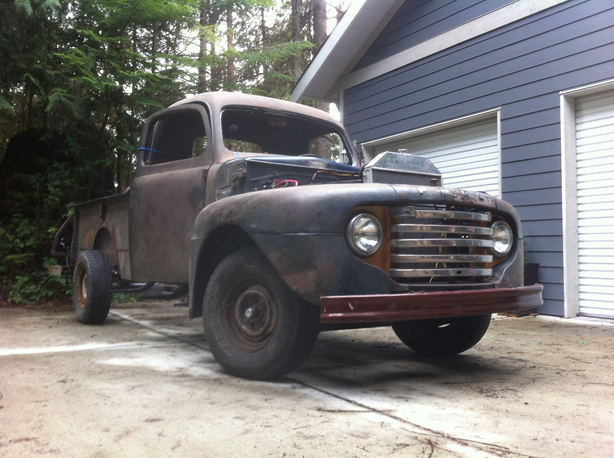

It's a period aftermarket bumper Badger Hound gave to me for the cost of shipping it. It fits the truck perfectly. After trimming it for the long bed, at least.
Not sure if i'd trust it to tow a car trailer but i'll just put on a real hitch for that.

That bumper has traveled more than some people I know. Made in Ohio, I bought it on my truck in California, brought it back to Michigan and finally sent it to Steve in BC!
Steve - that truck is really looking beastly. Have you considered putting a grill guard on the front? Also, it would make a cool looking plow truck with an antique, safety orange plow on the front... that said, it would probably be hard to control in the snow just being RWD.

i thought about it but i have a '51 bumper that came off a really nice F1 that the guy was 'upgrading' to chrome on.
I really like how wrong the nicely painted bumper looks on an otherwise derelict war horse. For which the one you sent me is the perfect contrast. Hope you don't mind me cutting those wings off too much.
As for a snow truck, I have too much mechanical sympathy. Sketchy's many days of neglect are over, albiet replaced with a novel form of 302 related abuse. But it'll at least not be seeing rain, let alone snow, ever again. Plus it'll spin the wheels if i let the clutch out too fast at idle in second gear. Snow's a s-no go, i suspect.

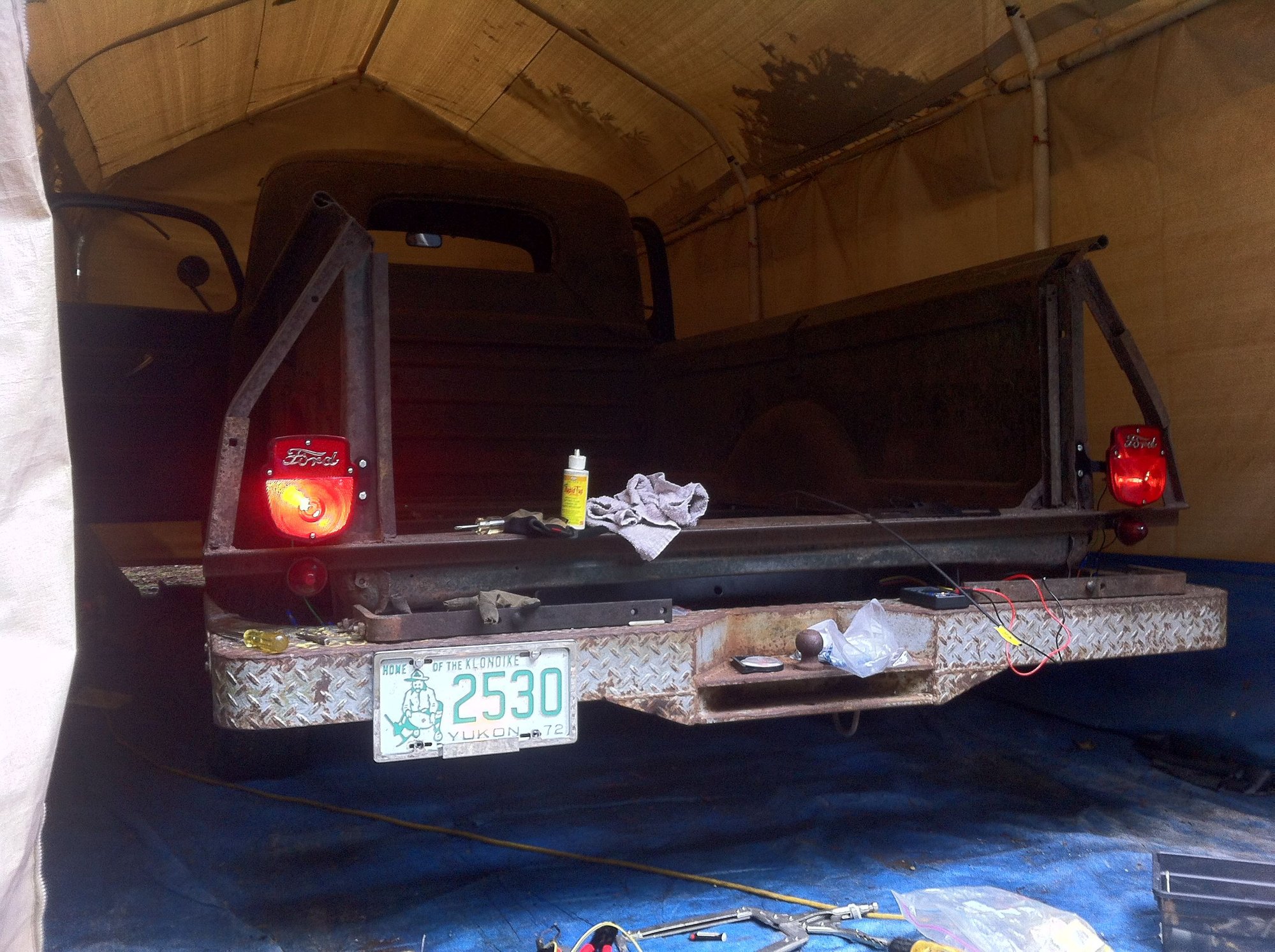

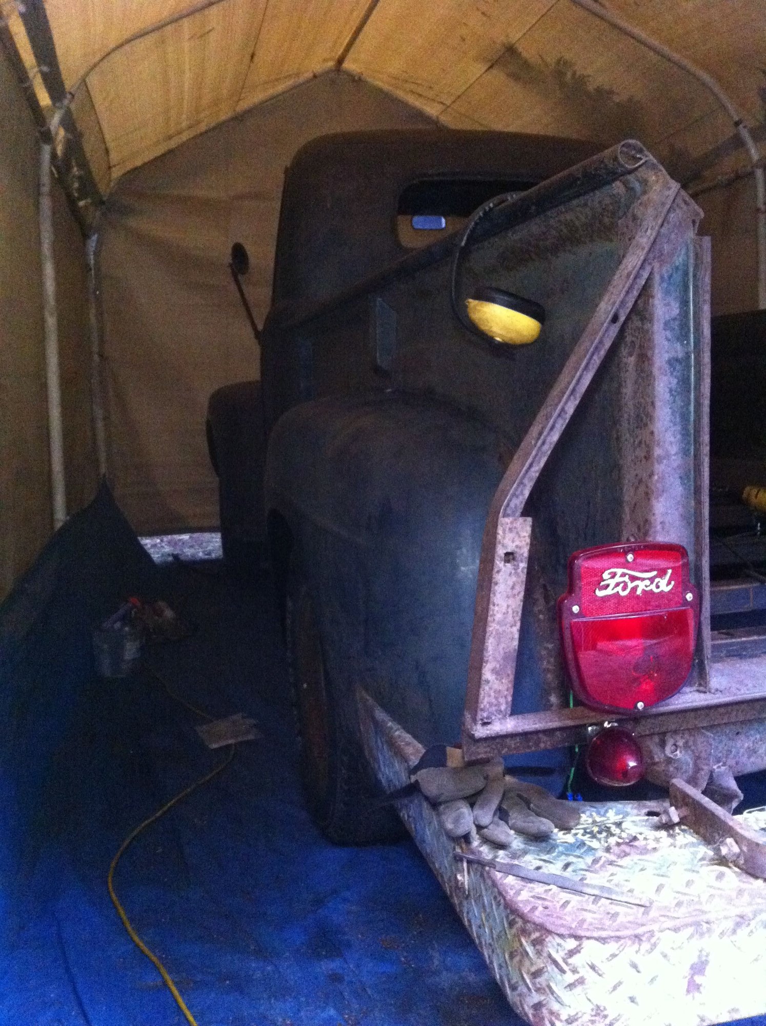

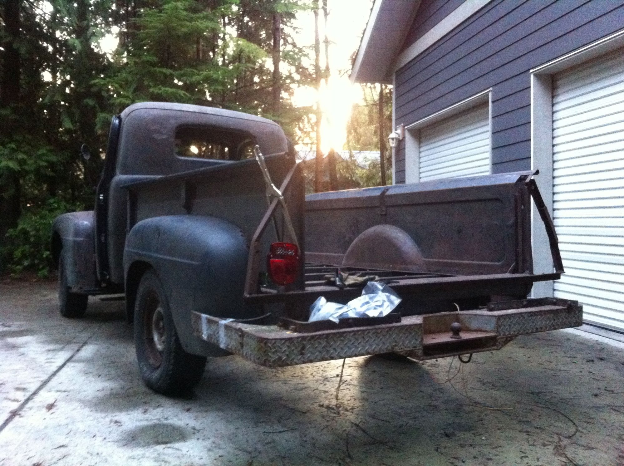

Was mocking up the tail lights but I'm not sure where to put them. Farmer ted welded those tiedown bars overtop where the stock ones bolted on so stock is not an option.
The turn signal switch i have doesnt do brake lights, so i gotta use 4 lights total. Plus i gotta light the liscence plate with marker/running lights, so i most likely need to attatch the plate to one of the lights. I would also like to be able to take the big diamond plate bumper off at will without issue, so I'd prefer not to bolt lights onto that.
The option I like most is putting the shield lights on top and using that as brake and turn signals, and making the tiedown bar into a box section with more angle iron and attatching the plate frame to that light. Was hoping to get some opinions on what to do.

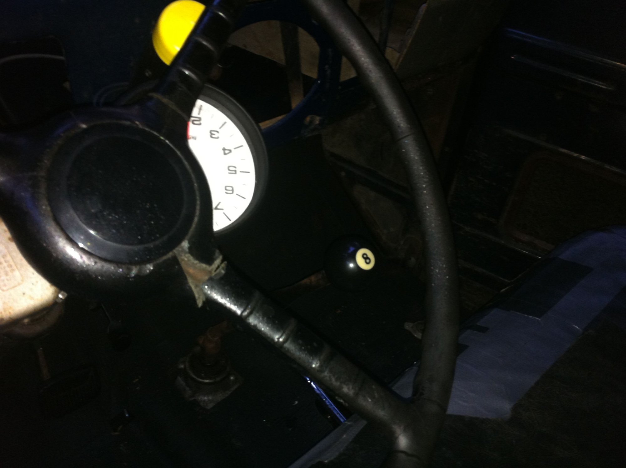

Oh yeah and i installed the most important part of the truck. Can't go wrong with an 8 ball.

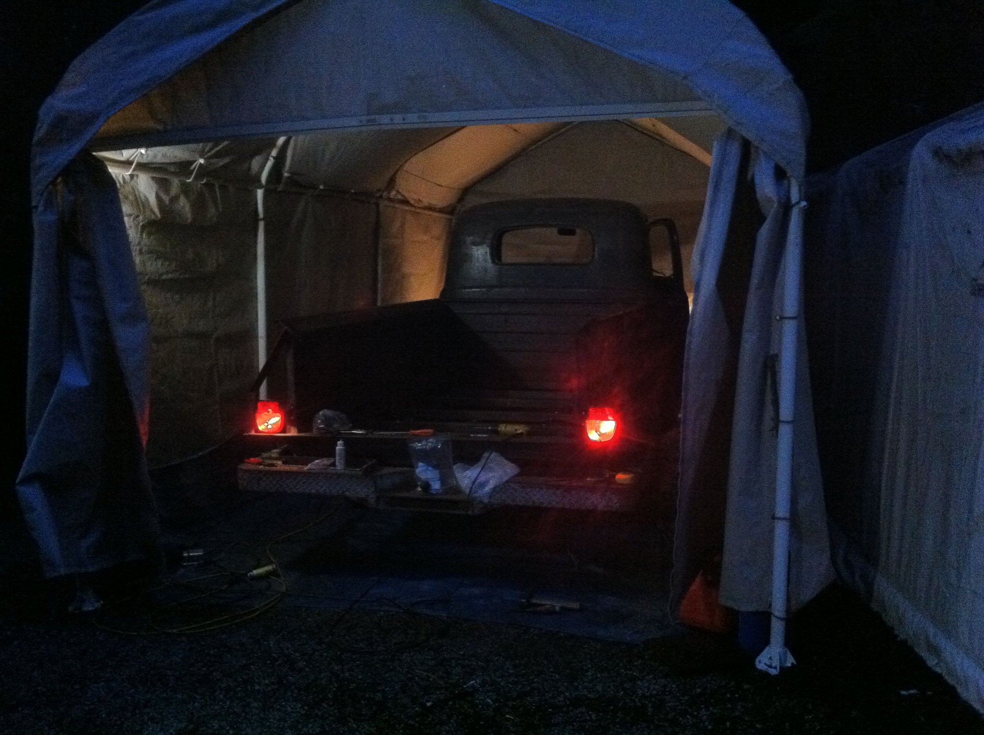

Got the lights on, sat in the truck and realized i wired the turn signals backwards. Oops.

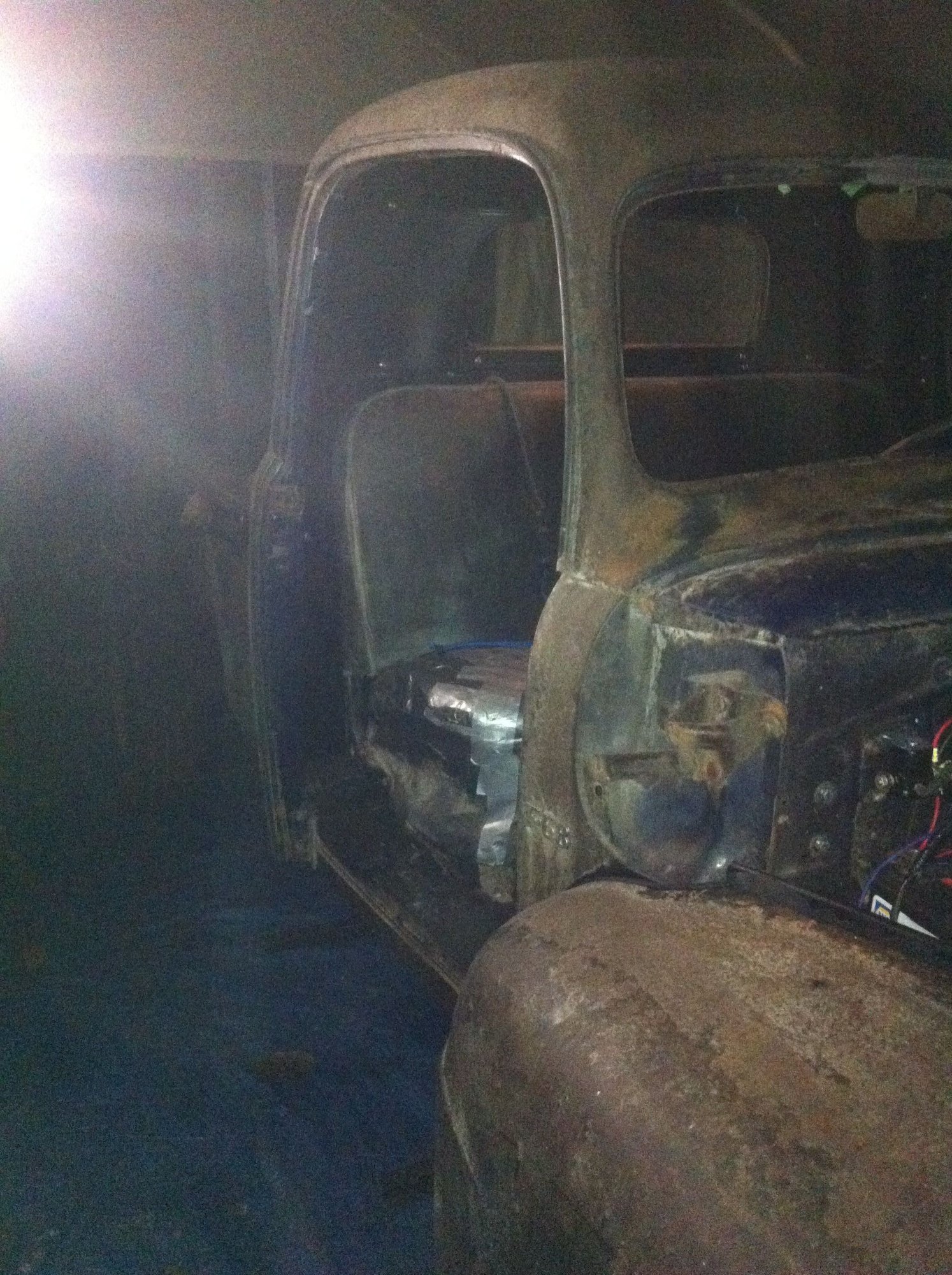

Also pulled the door off and got the lock cylinder and mechanism out, which was probably the largest obstacle left.

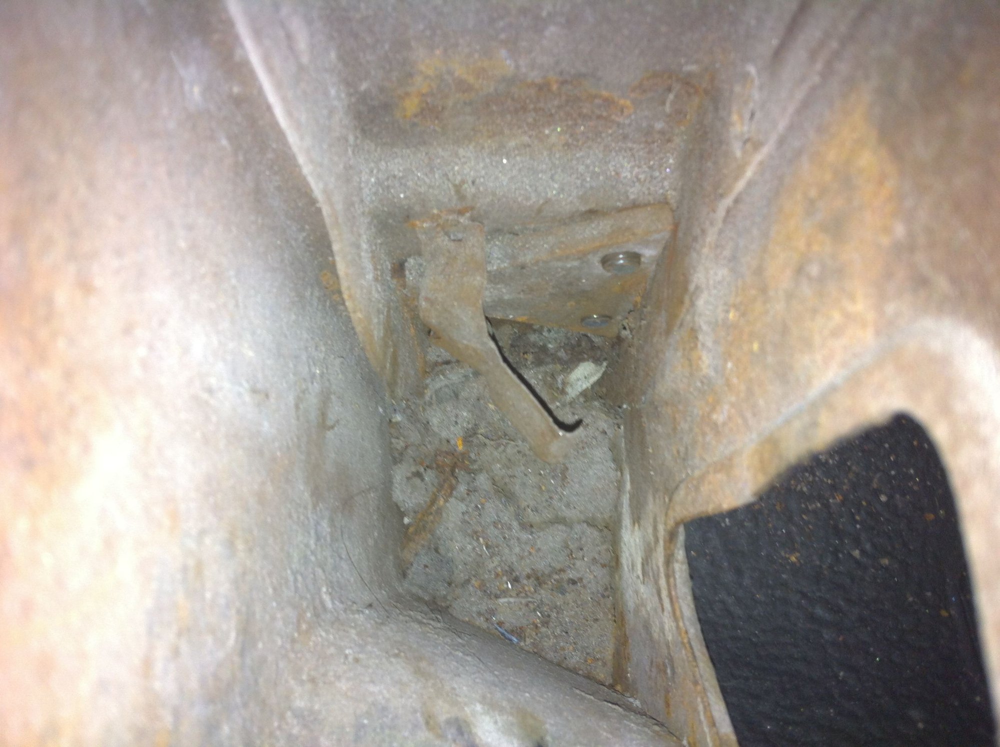

Went to put the door back on and discovered why it had sagged so bad. Someone busted off the retainer for the tapped plate that holds the door up. The plate was sitting loose at the bottom of the sill.
Thanks, farmer ted.

Just doing odds and sodds at this point. Finished some leftover wiring, got the plates and turn signals set up on it and put the fenders back on. Also ordered some slapper bars, so that'll be fun.

Keep plugging away Steve, the taillights fit perfectly in the openings!

I don't get around much but have never seen a turn signal switch that didn't incorporate the brake lamps. What brand is it?
Old Jan 30, 2021 | 01:57 PM
  #103
Steve Harlow's Avatar
Steve Harlow
Joined: Sep 2017
Posts: 714
Likes: 257
From: Sunshine Coast, BC
It's whatever the hell this thing is
Autolane i think? It's period aftermarket, i guess the intent was it was for vehicles not intended to have turn signals so they assumed it'd be an entirely separate circuit added on top. it's only got four wires, with the fourth being for a dash jewel i don't intend to use.
I embrace the jank. But please ignore the rats nest of wiring, i don't embrace that jank.
