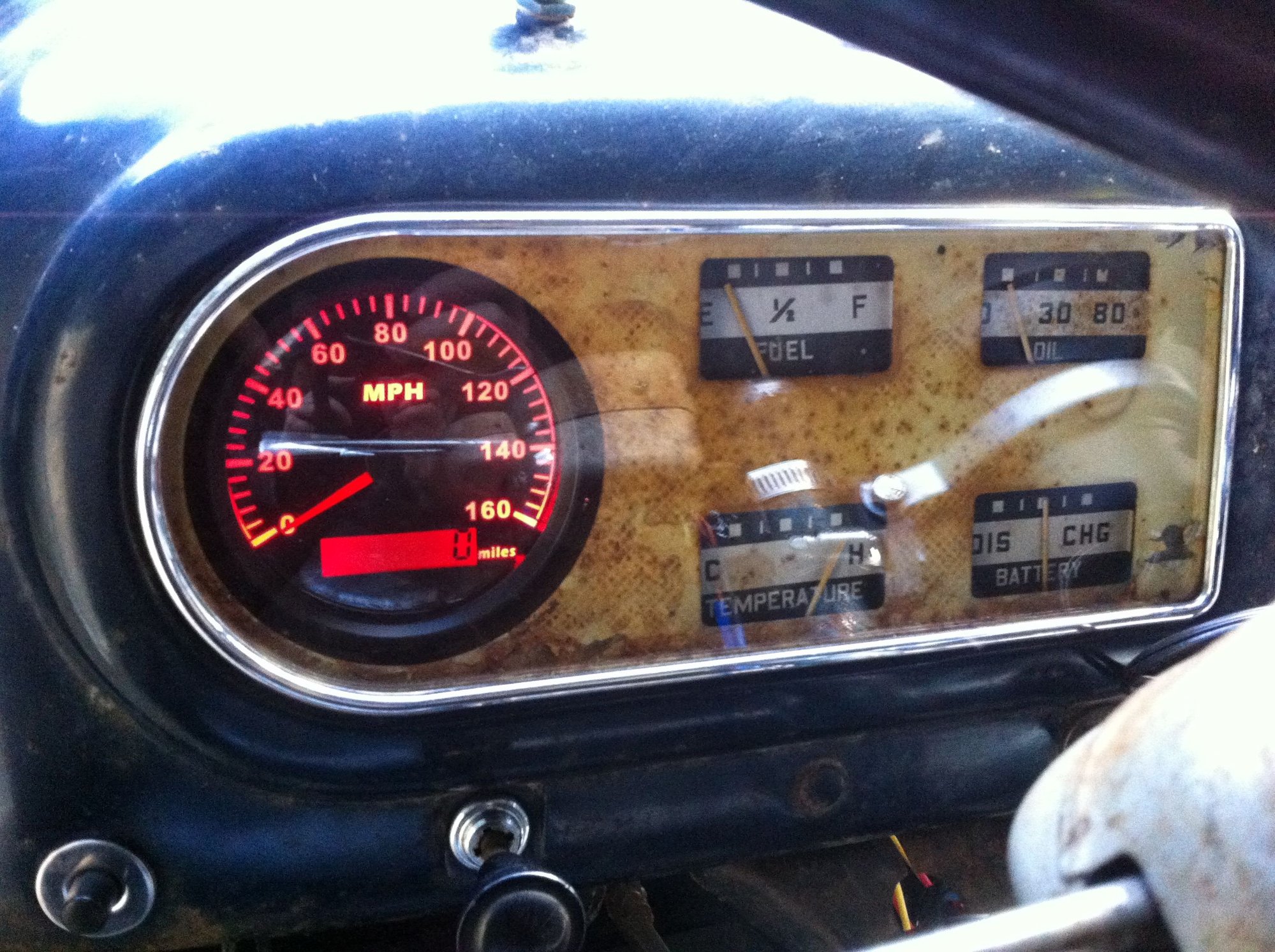

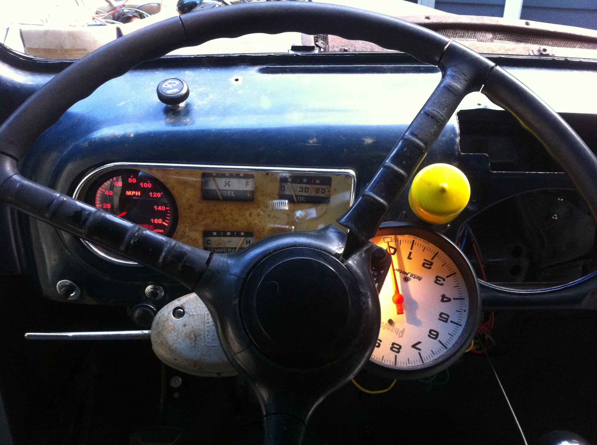

But, I did fit the GPS speedo.
Cheap Chinesium junk, but it works. Regrettibly the front appears to be bonded to it, as i wanted to make a nice faceplate for it. Oh well.
It's also in there until the end of time, between the electric wiper motor and my new pedal bracket it was not an easy job. Had to drop the entire pedal bracket to get it in there.
Ever onwards.

I feel your pain dealing with ICBC. Hopefully get your registration soon. Like the speedo.
You mentioned electric wiper. What did you do there?
take care,
Fred
Off the shelf kit from speedway
https://www.speedwaymotors.com/Speed...-Kit,8722.html
I wouldn't have bothered if it didn't need an inspection but here we are. Kit needed some fitting but it works

In other news, I took the truck around the block and the GPS speedo does actually work. Thanks china!

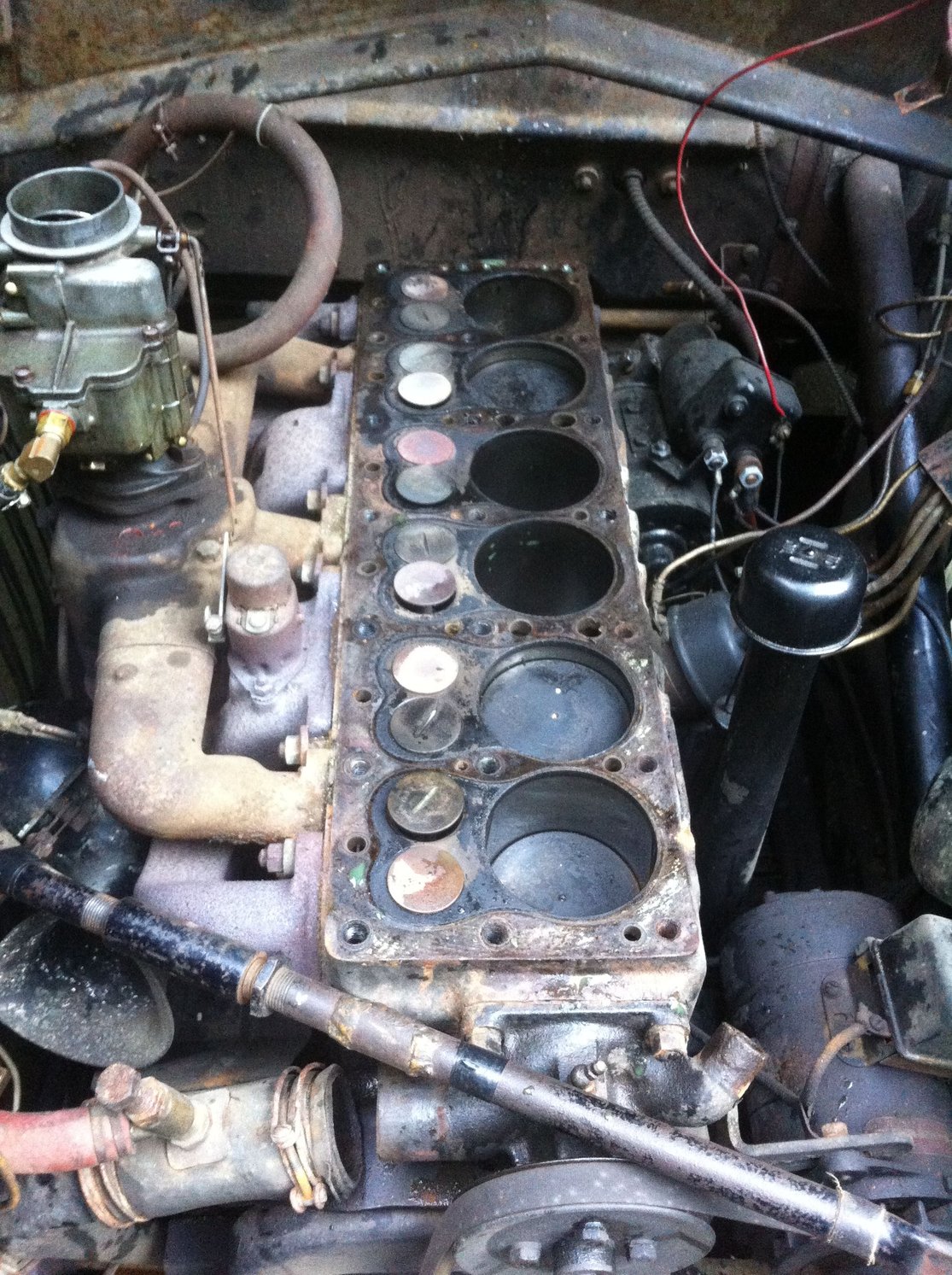

It's a chrysler flathead 6. I popped the head off, and apart from ridging, everything seems fine on 1-5. #6 is terribly pitted and scored.
I can't feel any rod play on any of them, nor is there any confetti. But 6 was trying to seize up. I need to pull the motor anyway for the clutch and motor mounts so i guess i'll pull it apart and see how bad it is. Really hoping a ring didn't turn into dust because this engine does not have an oil filter and I'm presuming i'm ****ed if that stuff gets into the oil passages.

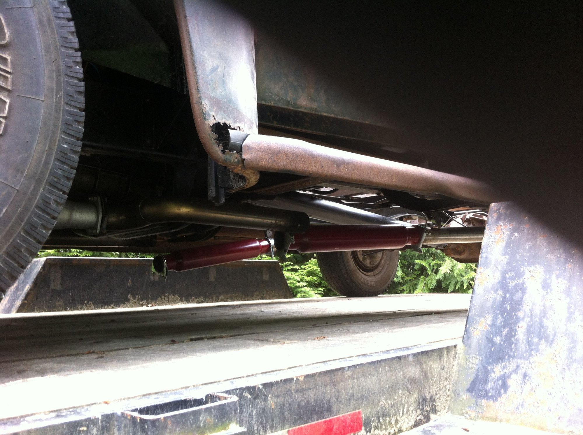

Absolutely had to spend an hour making new exhaust mounts out of scrap because i ripped that off going up the ramp. My fault for not sciencing it out. Oops.
