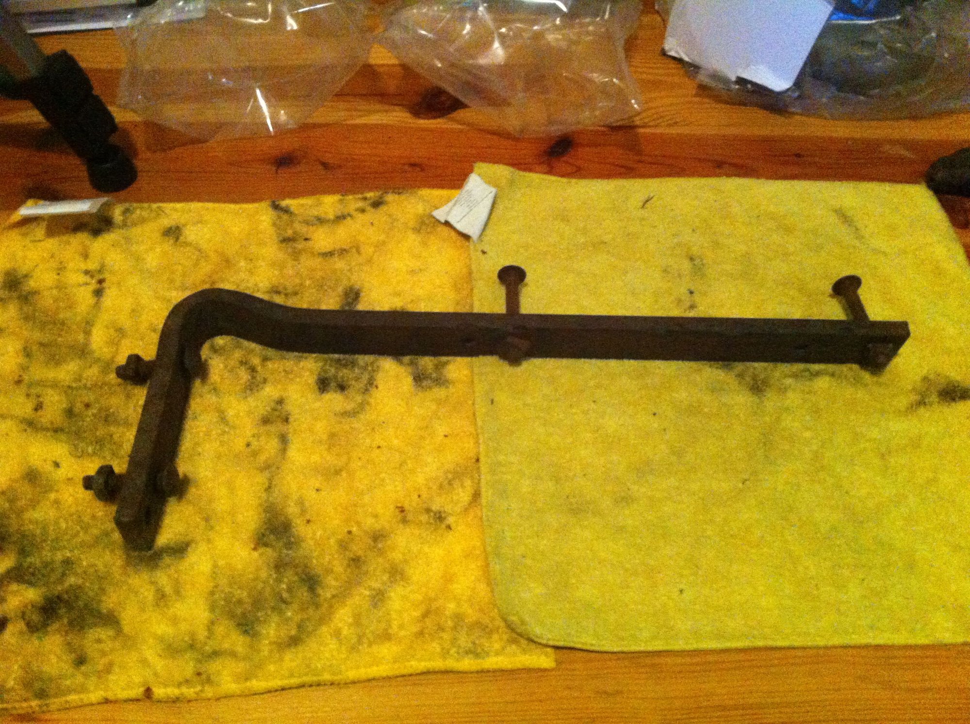

Can anyone identify this part? I have a symmmetrical pair of them, and i'm not sure what they are. I suspected they might be the rear bumper mounts but that doesn't appear to be the case.

Your picture looks like a bumper bracket, but aftermarket. Stu

Home made running board brackets ?

No it has the stock running board horns. And it doesnt appear to fit any of the holes at the back of the frame. Though the truck was rear ended at some point and that area's a little messed up, but nothing seemed to even remotely line up.

I will bite! Not sure its even a truck part? It has square nuts on carriage bolts? Did Ford uses either of those on these trucks? My guess its off of a farm implement??

The bed wood flanges were all held on with those same bolts, so it seemed to fit to me. Probably just a farmyard fix then.
It does have some booger welded tie down bars on the back (welded over the tailgate hinge holes, no less) with coach bolt holes in them. I'll see if the mystery part matches the holes in the tie down bars.

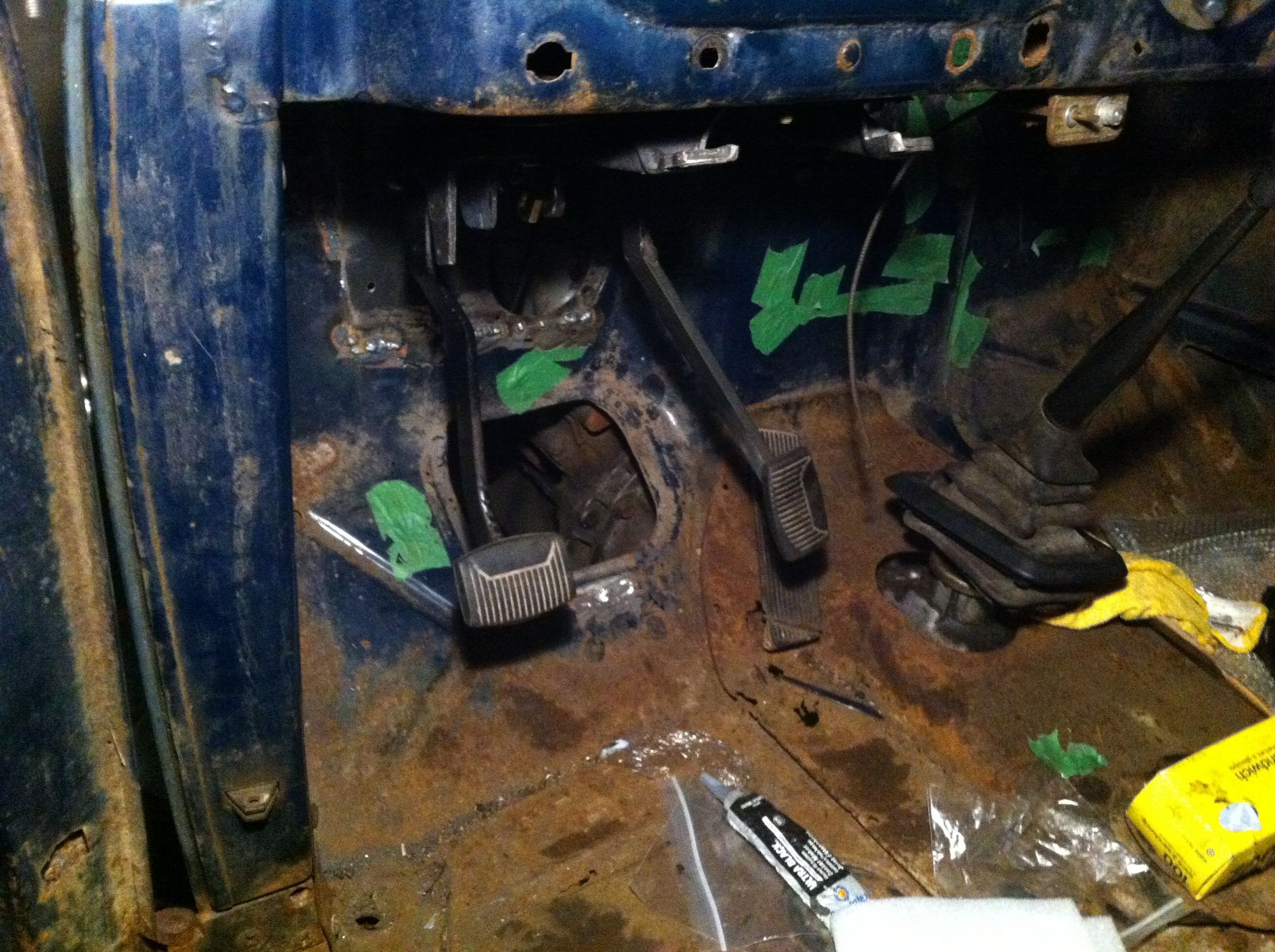

Brake booster, pedal box and clutch master is in. I'm going to have to basically make new pedals, since the brake pedal is right bang in the middle of where the column goes, and lengthen the pushrod, as the ranger booster puts the top of it's travel about halfway through the where clutch pedal stroke is.

Started mocking up the brake pedal. It's really really tight in there, with the brake pad horozontal, it almost hits both the gas pedal and the column at the same time, and the gas pedal feels really really low down compared to the other pedals. And the clutch pedal is also directly over the headlight dimmer switch.
Anyone have any advice on pedal placements? I'm getting to something ok, but any wisdom on what works and doesn't work would be appreciated.

Pedal box is done and adjusted up. Gotta figure out the loud pedal but that's easy.
