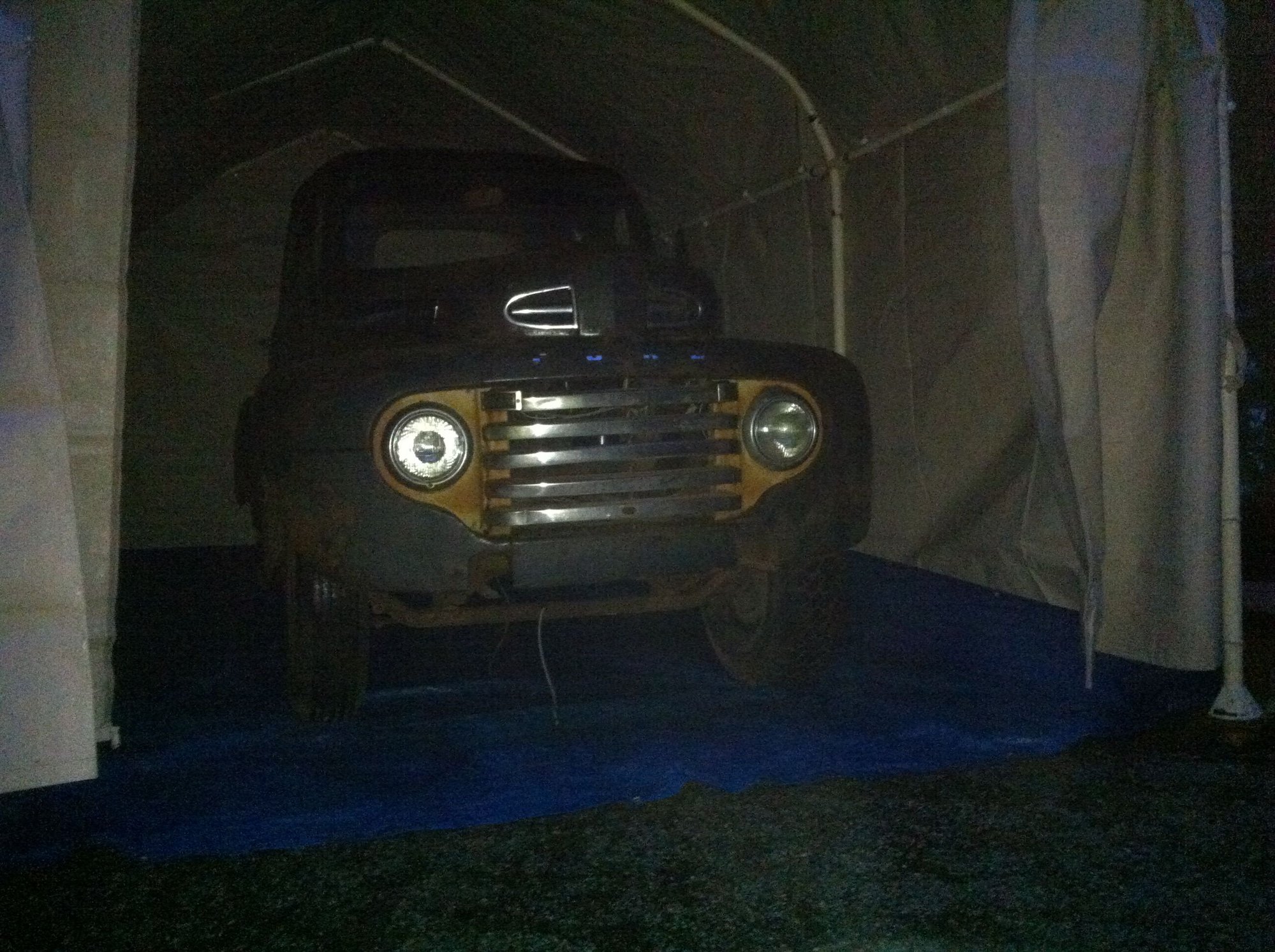

got the truck a new home. Now i can actually work on it before june.
Also were the beds typically welded together into one piece? I was expecting the three sides to bolt together but it's all welded into one piece. Was that factory or is this a farmyard "**** it that'll do" kind of fix?
The weld along the rear crossmember is a booger weld, but the actual joining welds on the cab side posts are pretty good so i'm not sure what's going on here.

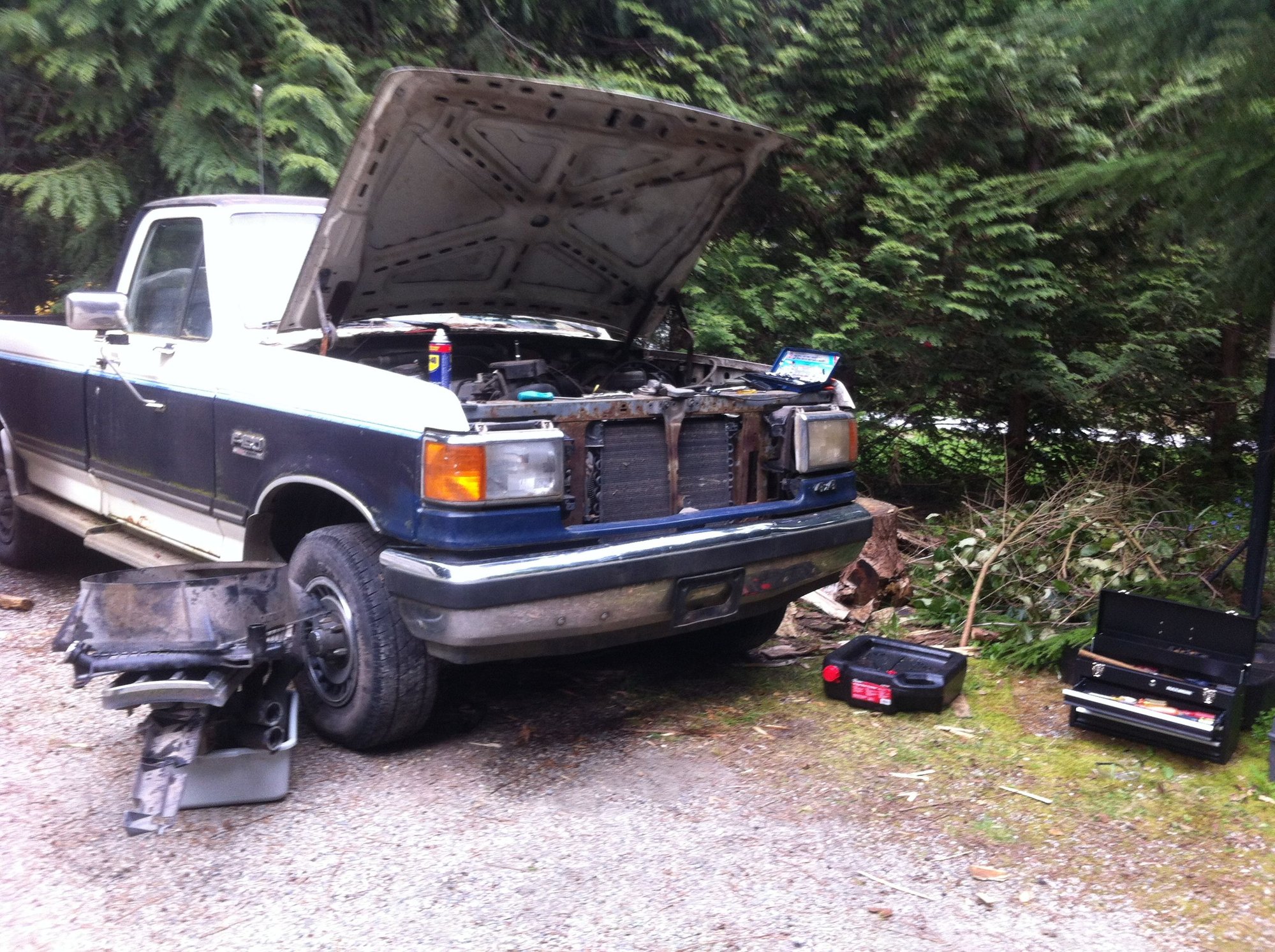

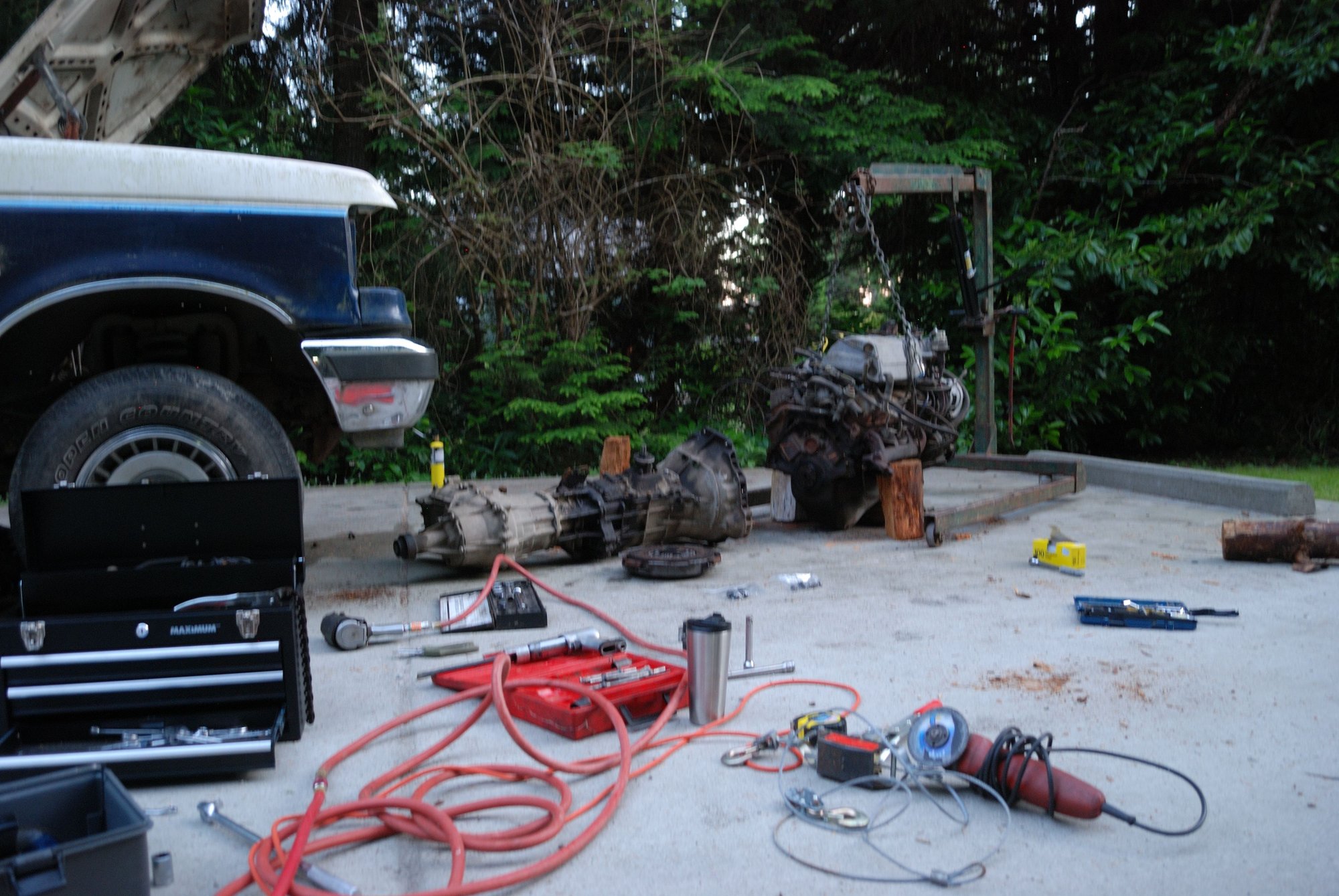

Well, been going slow. Been buying up parts and stockpiling them, waiting for the weather to warm up since i can't start grinding, finishing and painting the guts of the thing until it's 20 degrees out, and it's barely cracking 12 at the moment.
But i got a donor truck. It's got the 302 and ford 4 speed manual with OD, effectively a five speed, plus an 8.8 inch i'll be porting over. Bought some GT40p heads from the junkyard, on the hunt for a 650CFM carb and dual plane intake manifold, gonna shell out for a motor mount kit soon and drop in the motor. After that i'll have to wait for the summer heat to paint the underside of it, and it's nickle and dime stuff after that.

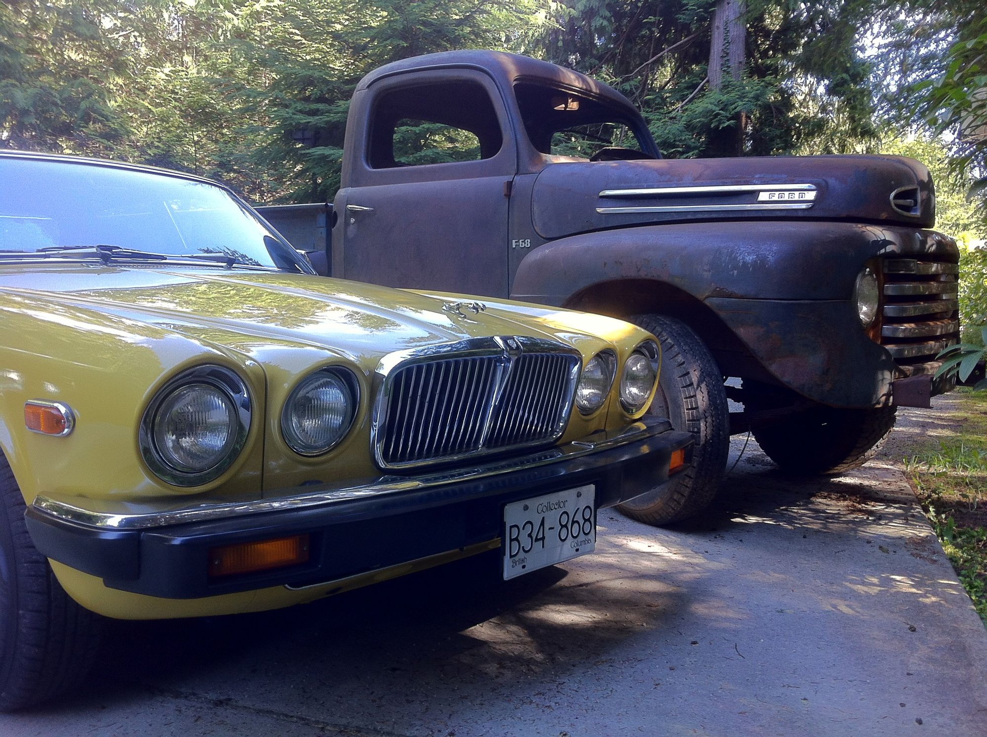

Also had the jaguar out today, couldn't help but put them side by side. Beauty and the Beast, together at last.

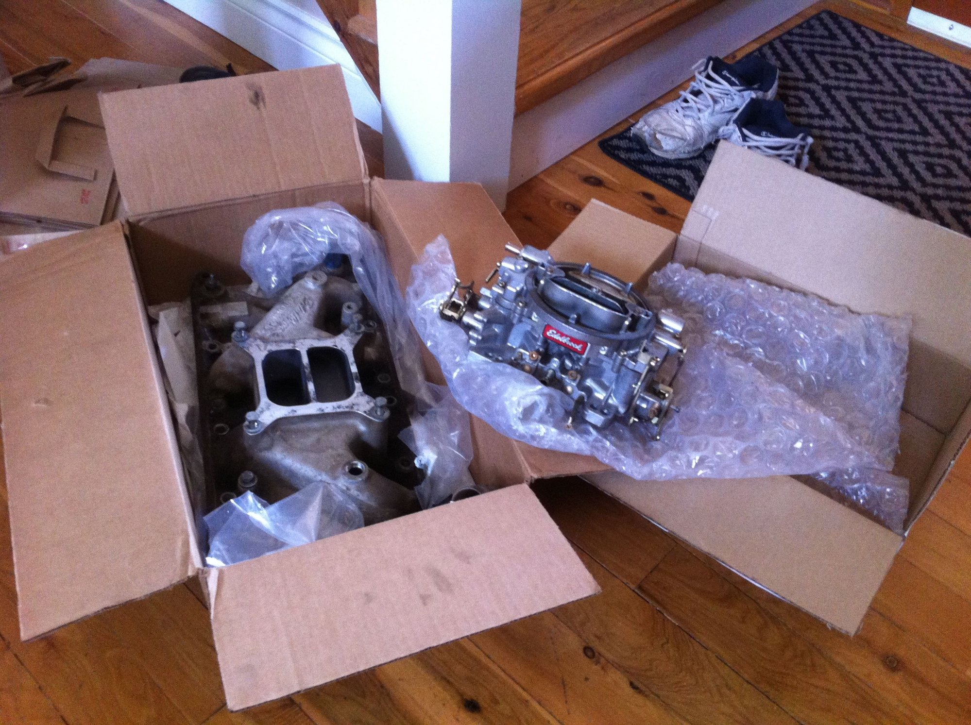

All the good things in life show up in nondescript cardboard boxes.
Just waiting on the clutch to show up and the motor's free to go in

600CFM of merry, indeed.
