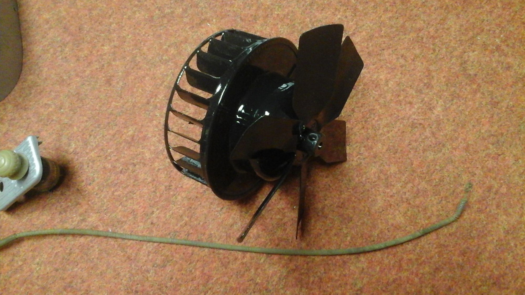

The three door units have this inside:

FortyNiner, Thanks for posting the pic of the fan. That shows exactly what I was trying to explain.

Yeah, thanks for the pics (I had to switch to Firefox browser instead of Chrome to see them). I'm assuming the blade fan is towards rear of truck and is adjacent to the core. I managed to use a mirror and see that there is no blade fan in mine and only about a 1/4 in from the snout of the cage fan to the core. There was an old core in the pile of parts I got with the truck, I didn't compare the thickness to what's in there now -I'll take the shroud off and check that.
