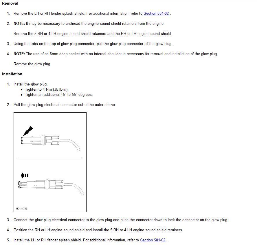

Replacement procedure from the 2014 Ford Workshop Service DVD...
