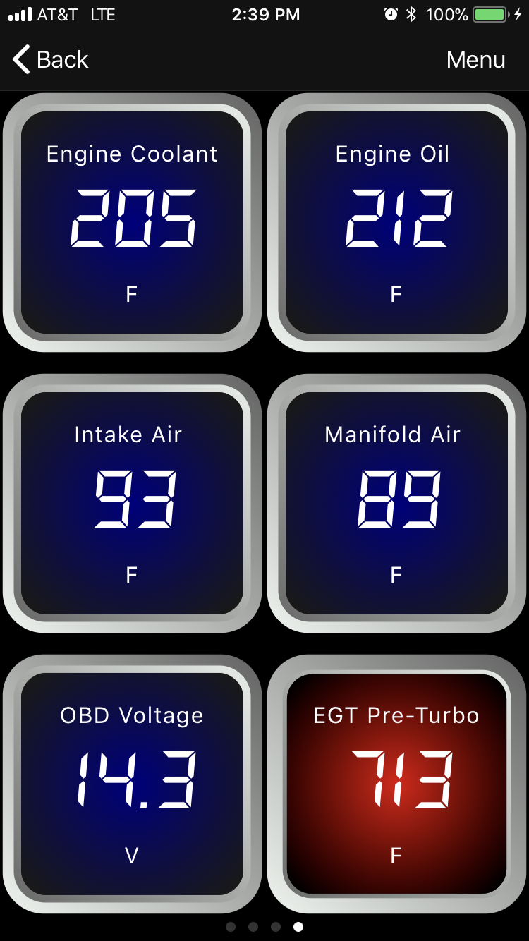

This is a picture of my digital gages:
With the grill cover on, true outside temps of 28F, fully heat soaked motor, here are my observations:
- intake air is an SAE PID that is pulling the air temp at MAF
- manifold air is PID 2216a8 and is the sensor on the intake manifold
Around town at 25mph I saw intake air temps as high as 95F, no real air flowing in the engine bay.
At 60mph I saw intake temps around 45F, seemed there was good air flow in the engine bay.
At 70mph I saw intake temps as high as 60F, stalled air in the engine bay.
I’ll have my grommet kit on Tuesday and then i’ll Re-create my observations with a little more air flowing through the grill cover. As an FYI, earlier this week I saw intake temps of 105F around town as I was running errands while the outside temp was 32F, this is the primary reason I’m going to add grommets to the grill cover.

Summary:
- My grill cover is now folded and tucked behind the seat until temperatures are much colder than 28F.
Detail Observations:
The following are my observations, all conducted in motor heat soaked conditions with outside temperatures at 28F to 30F.
The picture above represents my digital games after the following conditions:
- pushed the truck up to 80mph, observed my coolant temps pop from 195F to 205F after the intake air temp went > 80F. Then I slowed the truck to 70mph and the coolant and intake air temps never recovered.
The picture above represents my digital gages after many miles at 70mph followed by exiting the freeway for fuel, which was less then 1/4 mile away. This is the picture as I pulled up to the pump.
The picture above represents my digital gages with the grill cover removed after driving many miles at 70mph.
Old Dec 22, 2017 | 05:18 PM
  #42
Copper.Farm's Avatar
Copper.Farm
Joined: Dec 2016
Posts: 1,284
From: Bozeman MT
The under the hood temperatures were very warm to the touch confirming the 115F at MAF.
The most noticeable difference was exhaust temps.
My conclusion is that the grill cover helps to create a nice warm summer day under the hood, which means more turbo to make pressure because the intake is warmer with the net result of warmer exhaust temperatures.
After this, personally I would not tow weight with the grill cover on unless the outside temperatures are well below 28F.
Kind of fun exploring all of this!
