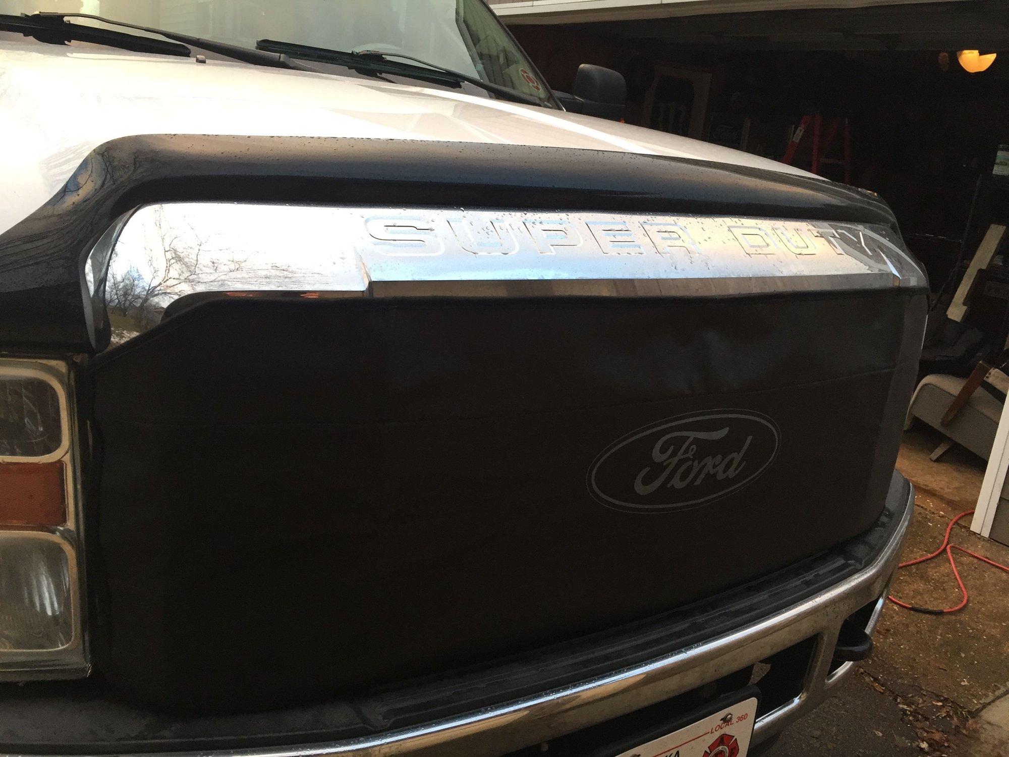

Alright so quick question here. I received the cover today and went ahead and installed it. Have to say I am disappointed the hooks are plastic but I will just have to deal with it. Anyways I got the cover off eBay. In great advertised shape, expect the fact that they didn’t say it came from a smokers truck. My question is will the cover air out since it’s spread out on the truck? Or is the smoke smell gonna get sucked up and blown into my truck with the heat on?

Cigarette smoke bothers me. Plus my wife and son are both asthmatics so the smoke of sucked in would get to them quickly. Will see tomorrow. Hopefully all good When spring hits I will wash it in odorban and that should take care of that, the bag is soaking currently.
Quick picture of it installed.

Nice bra Seth. Warm it up and get it tighter.
Your wanting to soak it down with odorban or equiv.
Overnight will be the dif.
I'd also offer to hose it down with 303. Longevity.
It is a nice addy for temps, eh. Member 50 degrees tops 32 towing.
Look into the superduty stickers for grill and tail on ebay, I'll try to send the link. Really sparkles.
Denny

Defiantly warms up quicker. Not bad to look at. I might take it off and wash it with some dawn just to at least clean it up a little.
