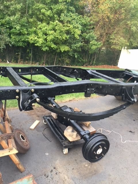

I took mine to the bare frame and used a wet sand blaster with a pressure washer to knock off all the big chunks. Gave it a good cleaning with phosphoric acid then primed with rust-oleum primer and top coated with rust-oleum semi gloss black. It isn't as durable as the POR 15 but it is equal to the what the factory used. And way easy to fix if it gets dinged.

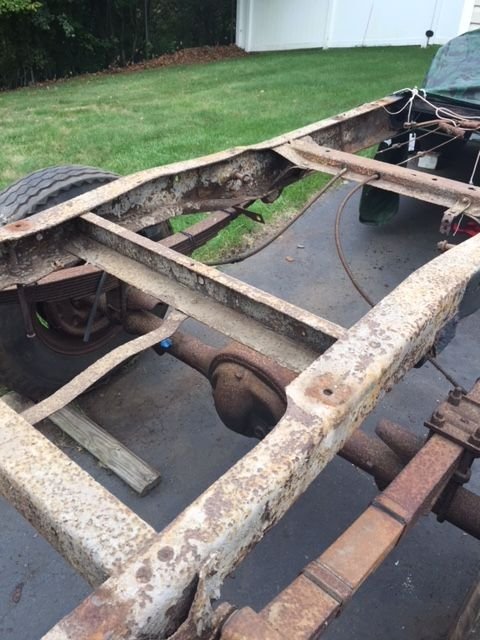

I used Eastwoods rust encapsulator. Did the bottom of cab and frame. I wire wheeled the frame, pressure washed it, degreased it, applied rust encasulator with a brush and then painted over with gloss black. Here are some pics from about a 1 year ago. The frame is in driveway (no room in garage) and it's been tarped. So far, it looks like the day I applied it as in this picture. I won't know how well it will hold up once on the road (that's still a long ways off at my pace), but so far so good and it is easy to put on.
