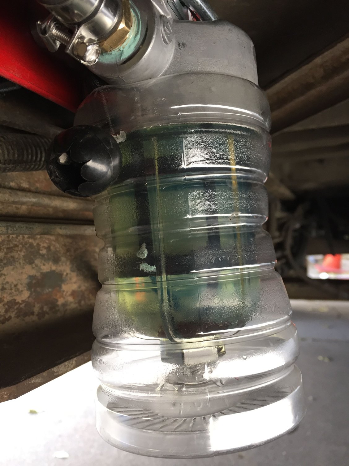

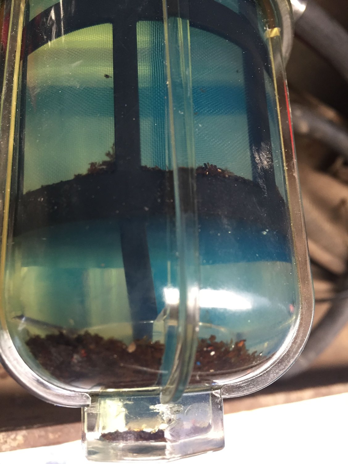

I only drove the truck about a mile to fill it up yesterday. I realized last night cleaning up I forgot to reinstall the screen in the pick up foot...it's staying out now. Anyway driving that mile last night and parking it, I went out to check for leaks this morning. Everything was bone dry BUT the filter has already caught debris that would have otherwise made it through the pump.
I'm sure some of you are chuckling about the plastic bottle over the filter but if think about how durable plastic bottles are it really does provide cheap, easy on/off protection. Even if I do a bash plate down the line I'll keep the plastic bottle on the filter.

That's quite a bit of debris for such a short period of time! Nice clean and creative work.

That's what I was thinking too. But I figure it was a combination of very low fuel level in tank and no pick up screen on the foot. Eventually I think the filter will help eliminate anything that was previously in the tank. Probably should have cleaned it and ran the fuel through a funnel with some coffee filters but that ain't happening now.

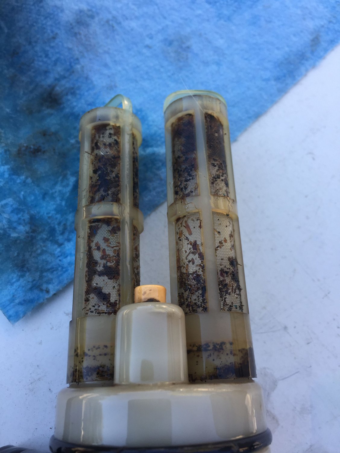

The truck has 376K on it, here's what the screens looked like when I pulled them out. I'm thinking someone replaced them at least once. I can't imagine 376K and the screens are that clean compared to what my filter has already removed and others I've seen posted here.

John, about a week after doing the hutch mod and installing the Racor I had debris in the Racor canister as well. Not nearly that much, but it looked very similar. I also contributed it to removing the sending unit and screens.
Since the initial dumping and cleaning of debris out of the Racor, I have not seen any other trash or debris getting into the Racor or the filter.
