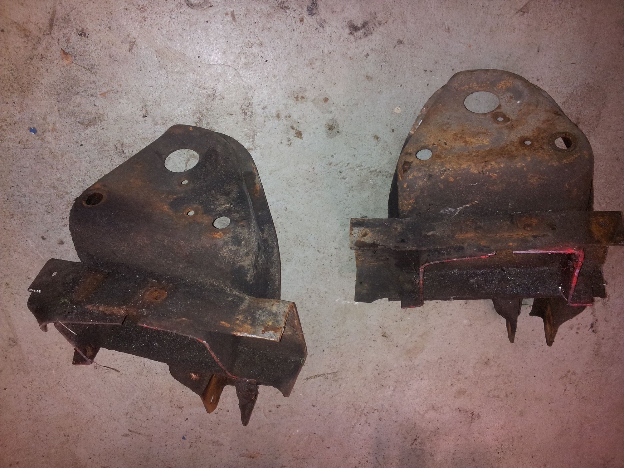

Old Nov 10, 2017 | 07:53 AM
fe390pc's Avatar
fe390pc
Joined: Mar 2009
Posts: 4,836
Likes: 596
From: Minnesota

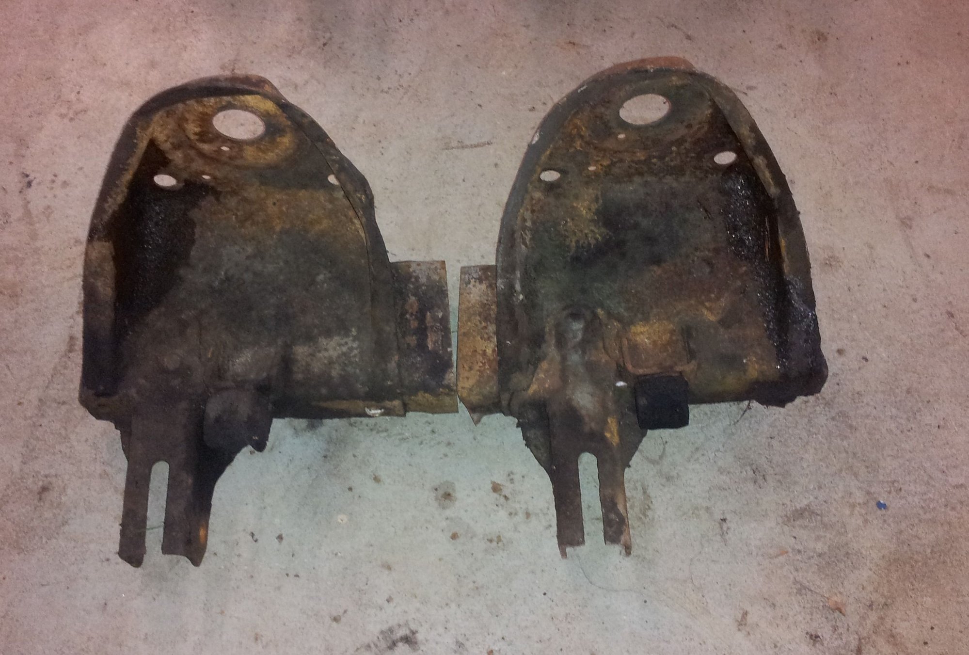

Here is what I have.
Cut off frame
Close up
Close up up side
Back side

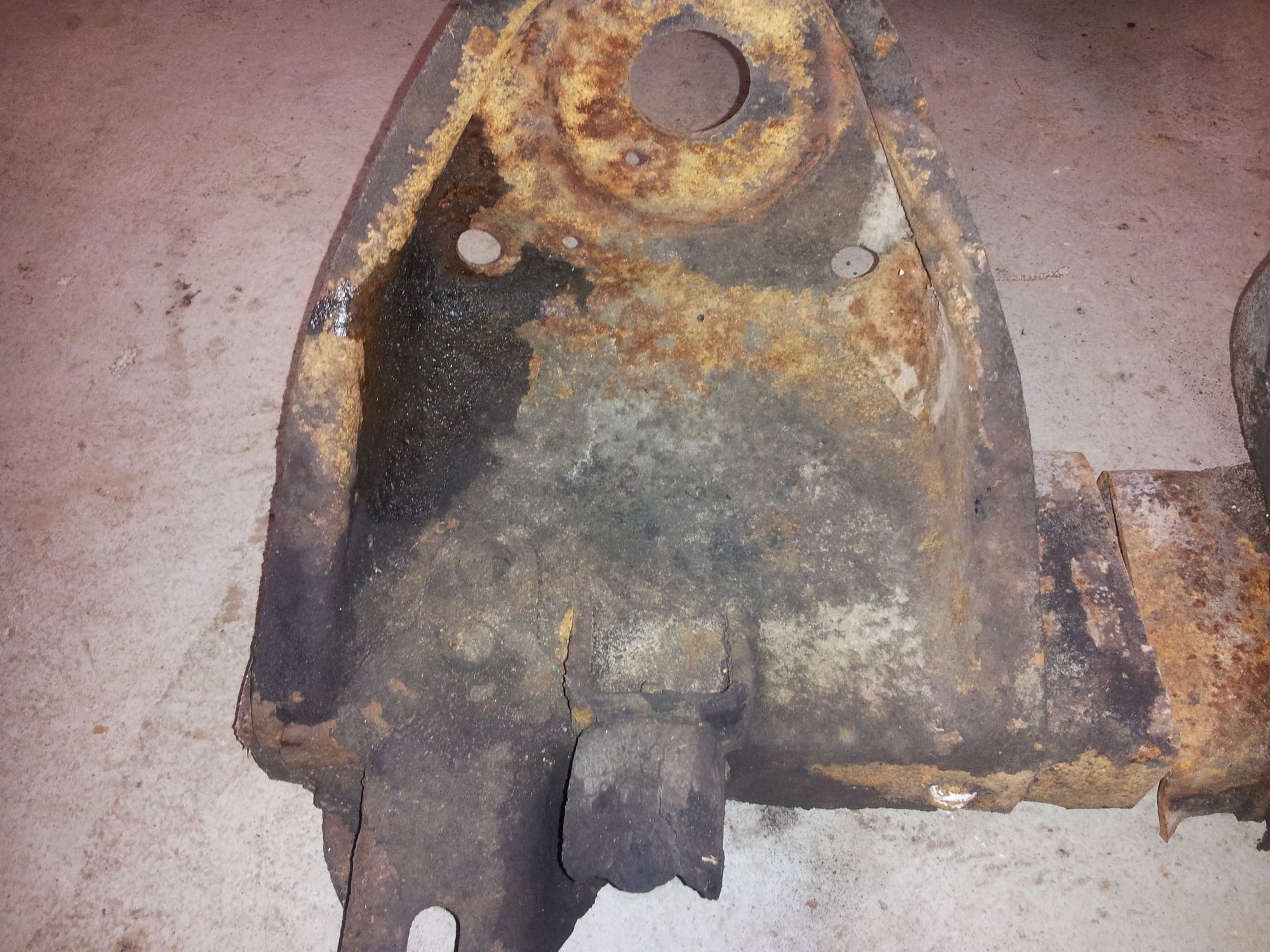

Old Nov 10, 2017 | 07:55 AM
fe390pc's Avatar
fe390pc
Joined: Mar 2009
Posts: 4,836
Likes: 596
From: Minnesota
Surface rust but no weak or thin spots that I can see. I can weigh them and get a shipping cost if you want?

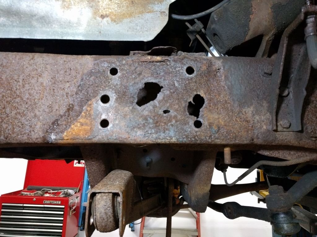

Old Nov 11, 2017 | 06:51 PM
fe390pc's Avatar
fe390pc
Joined: Mar 2009
Posts: 4,836
Likes: 596
From: Minnesota
Good luck. It is a royal pain to get those rivets out. Do you have a smoke wrench (torch)? It might be easier. Both of the front suspension mounts are in there as well. Look at yours once you have them off and decide which ones to use. Also get grade 8 fine thread hardware to replace the rivets you remove. Get the size that fits close or open them up to the next size up bolt.

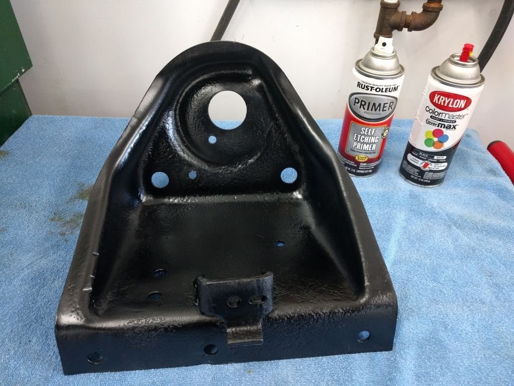

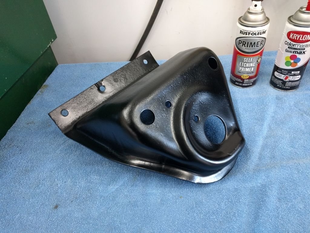

Old Nov 24, 2017 | 06:47 AM
TTurnquist's Avatar
TTurnquist
Joined: Sep 2000
Posts: 56
From: Mystic, Connecticut
Got 1 ready to go in.
The rivet holes are slightly bigger than 1/2" so I think I'll get some 14mm frame bolts and ream out the hole to an interference fit. There doesn't seem to be a partial thread 14mm bolt with a short enough non-threaded part that will work so I'll go with full fine thread.
Thanks fe390pc!
Old Nov 26, 2017 | 07:34 PM
fe390pc's Avatar
fe390pc
Joined: Mar 2009
Posts: 4,836
Likes: 596
From: Minnesota
That looks amazing. They are from an F250 so that could be the difference? Or just could have been that day of the week? Again they cleaned up very nice.

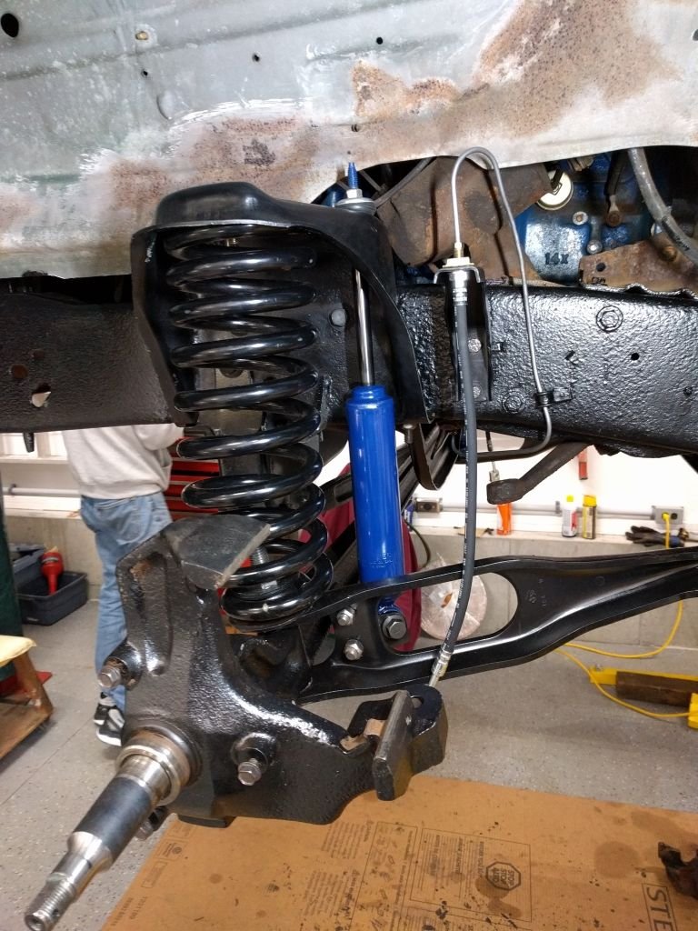

Old Feb 3, 2018 | 02:57 PM
  #29
TTurnquist's Avatar
TTurnquist
Joined: Sep 2000
Posts: 56
Finally finished! Got some 14mm partial thread frame bolts. Used part of the frame section that came with the buckets I got from fe390pc as reinforcement inside the frame. added two extra bolts. As you can see from the picture of the old shock the suspension wasn't moving much on that side. New springs, shocks, radius arm bushings on the arms I had new bolts put on, flex brake lines, brake pads, draglink, and inner and outer tie rod ends. Had the old rotors turned. Next project is the power brake upgrade and add power steering. It sure was nice to have use of the lift at my friends garage, that's why I helped him build it!
