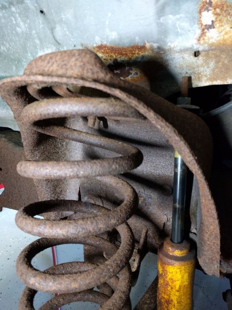

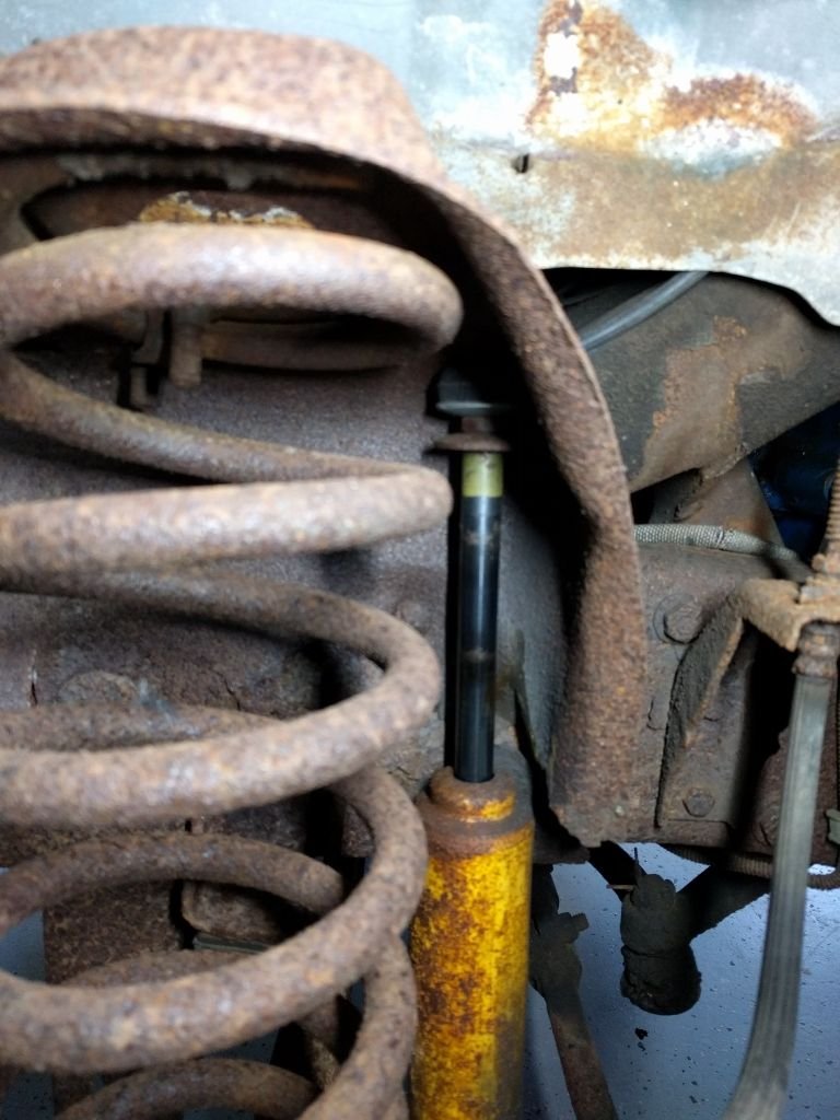

Truck is a 1978 F100, 300 six, 3 on the floor 2 wheel drive. The left front Spring/Shock mounting bracket has cracked allowing the shock body to hit the frame. I need to find one, or do the CV swap. Would rather keep it original.

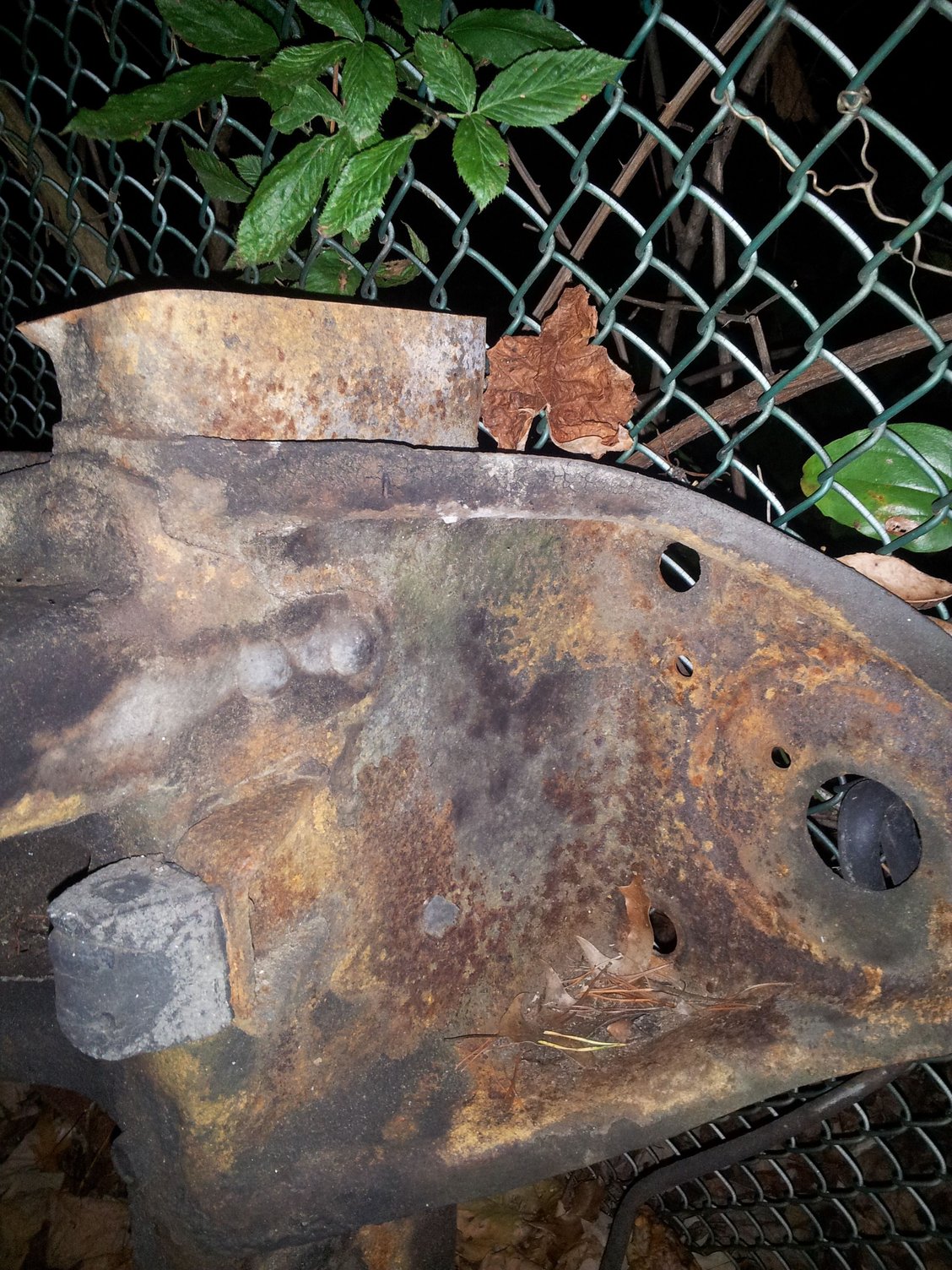

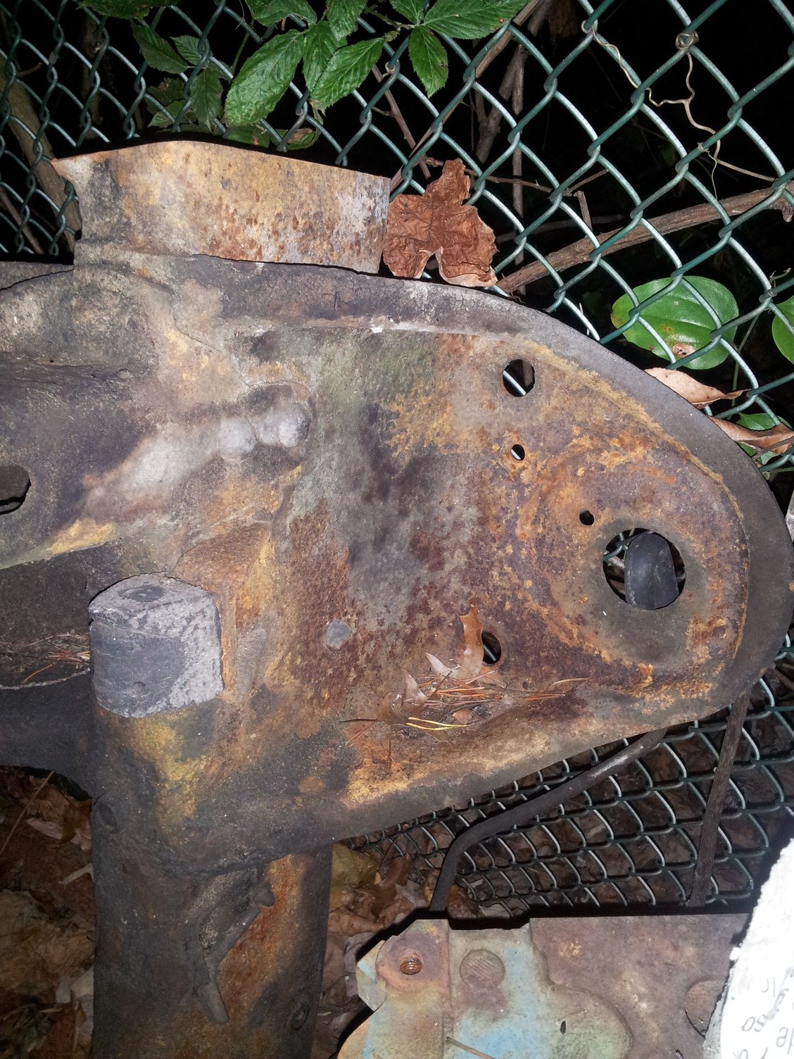

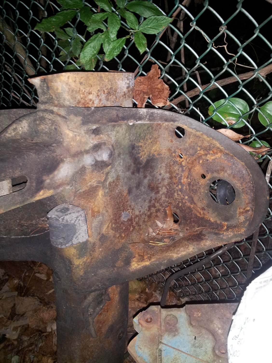

I have a cut off section of frame from a 1972 F250 that the buckets may be in good shape. Let me look tonight and get some pics. I believe thay are the same.

I would think they are the same. Looking forward to the pics.

Here are the pics.
First pic
second pic
Last pic. The other side is just the same.

They look the same, a little hard to tell from the angle. How much?
