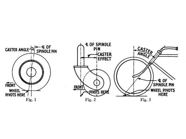

I’m no rocket scientist but I believe your shims are installed providing negative caster.
Fig 2 negative caster; Fig 3 positive caster
With the thick end of your shim in the back that drops (negative) the front of the axle like fig 2. Negative caster will cause wandering and erratic steering.
Last edited by bjmayberry2; Oct 30, 2017 at 03:30 PM. Reason: Added a Negative Caster statement

Dawgaroo
Uh Oh, did I just enable you to go out and spend big bucks on a fancy chassis?? LOL
For the darting around on regular driving a few degrees of caster would probably help a bit. You can buy caster shims in 2 degree increments. I think 4 degrees should be plenty
Bobby

I put 4 in it when I installed the axle Bobby. Thick side facing rear. I believe orientation is correct?
