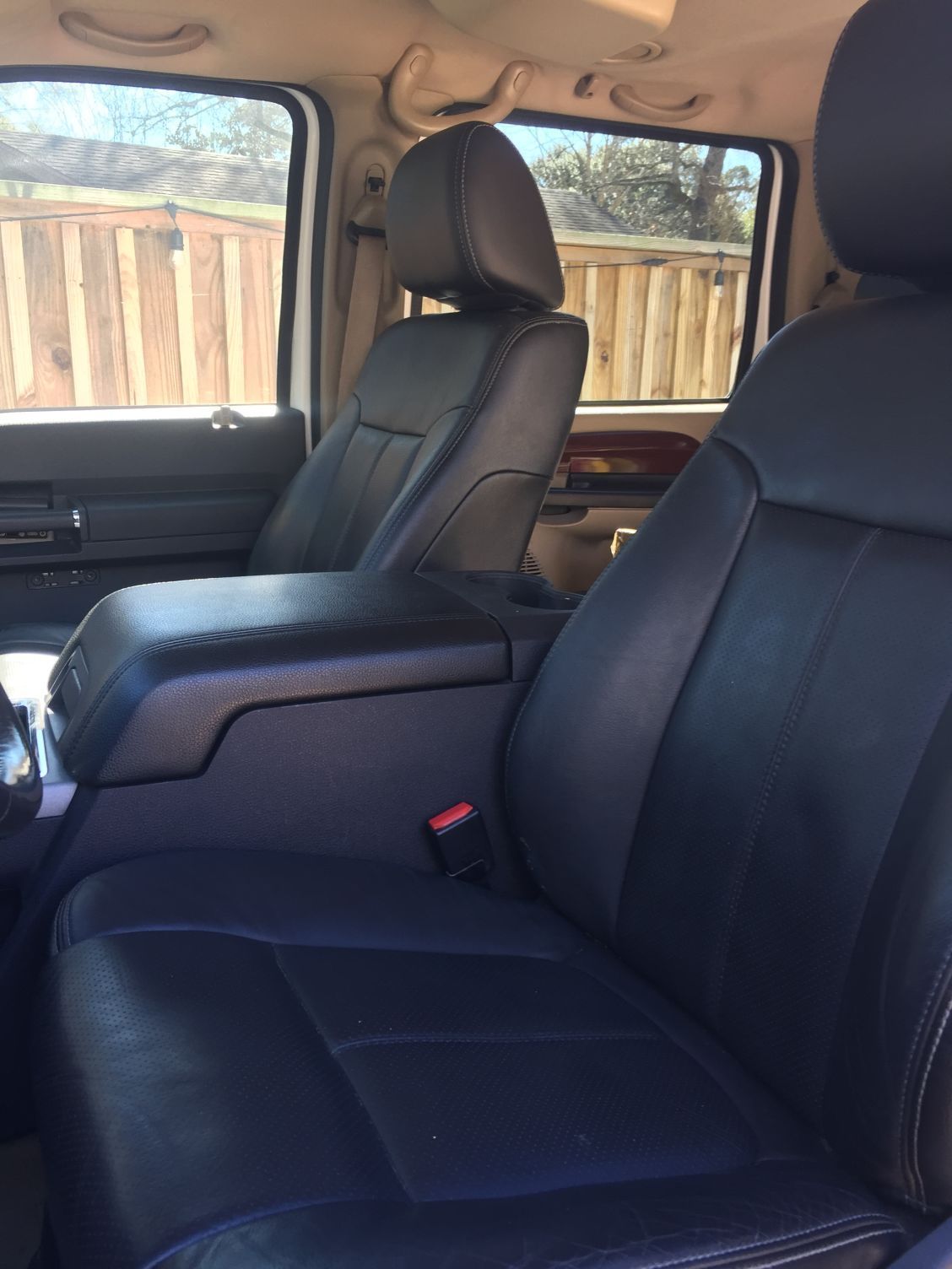

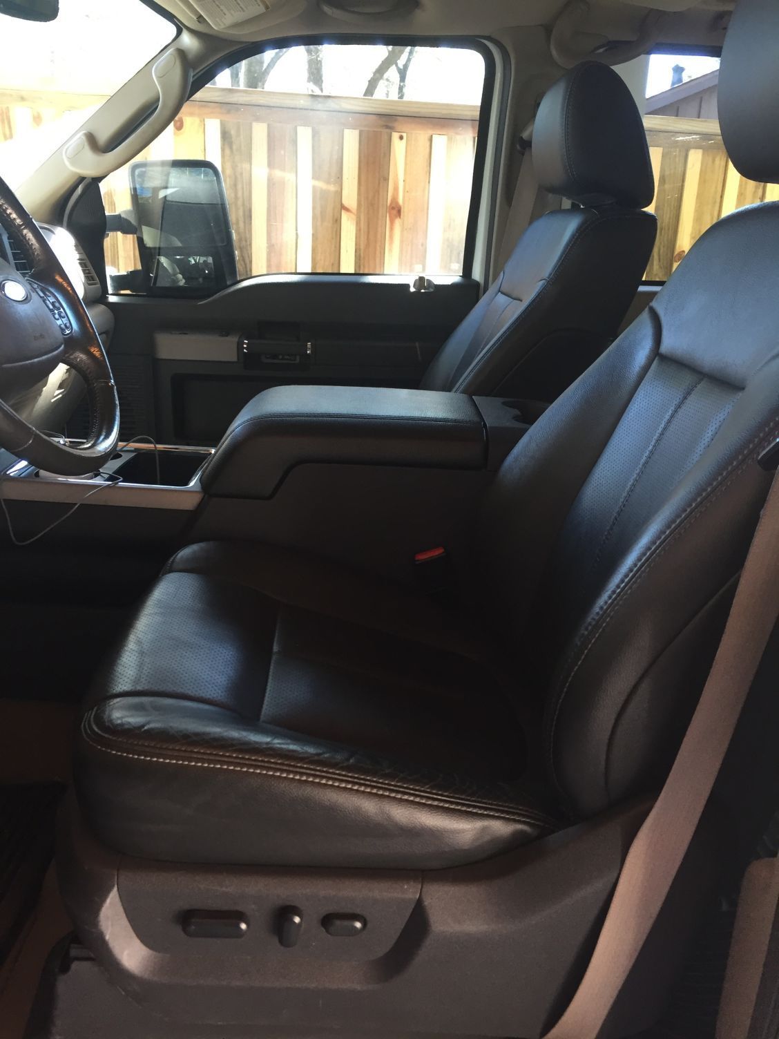

2015 Super Duty seats comfortable and cooling

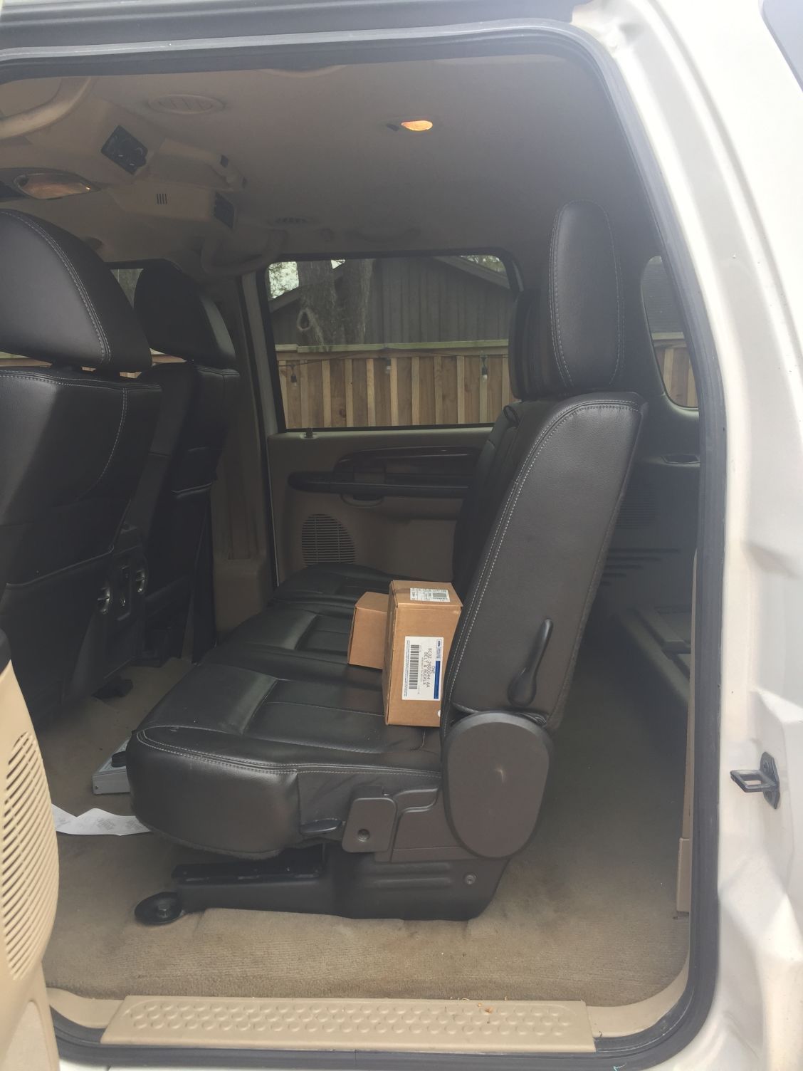

5HUB, were the 2015 seats a direct bolt-in? What kind of mods, if any, were needed to install the 2nd row seats?

Fronts were direct bolt in, wired in cooling. Middle row mounts were chopped and welded back on at different angle.
