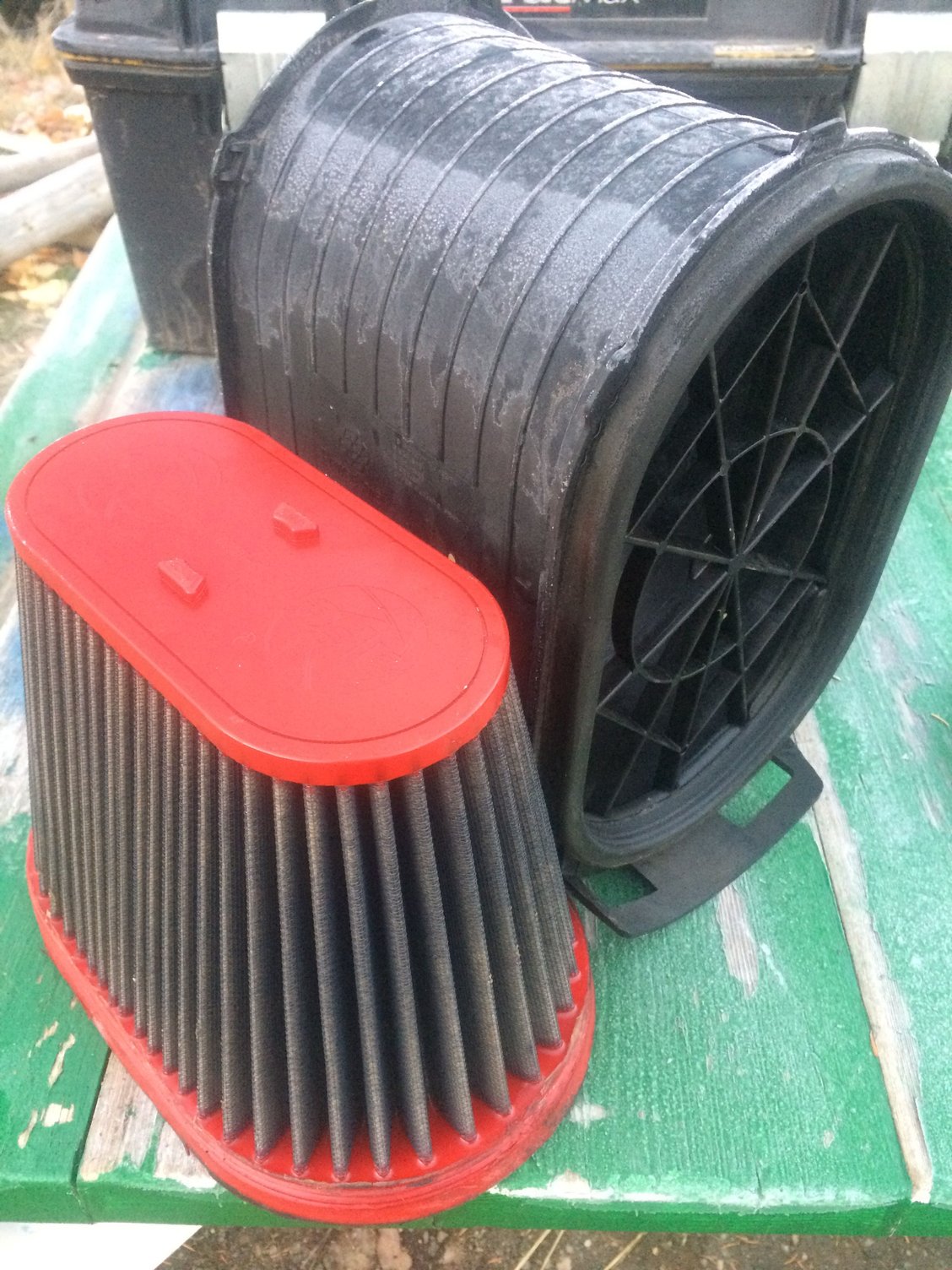

Originally Posted by Toreador_Diesel
Looks to me like someone found a way to put it in backwards
That definitely would explain why your fuel economy is in the tank. Clean out that intake tube and clean your MAF, you should have a happier truck then.
Yeah, reverse flow -- haven't seen one, but that doesn't mean they aren't out there, or someone custom made it to flow inside to out... Some really clogged pleats for-sure...

I can't shed any light on the backwards filter thing, other than it seemed to fit well like that.
What matters a lot more is that my truck now has a new OEM air filter. My engine and I are both very grateful for everyone's help and advice! My knees will probably forgive y'all later
MAF is cleaned and shiny, and the MAP hose and nipple are clear. There was just a little soot in each.
I got everything put together just in time to go pick up my son from work and took it for a good drive, and it seems to be running great. The fuel tank is full and I'm actually looking forward to calculating my mileage!
Edit Nov 14 - I found a link for this set up: http://www.pmtdiesel.com/AFE_Ford_Di...ter_10100.html
Just thought I'd document this, in case it comes up again. Here are some more complete shots of the AFE set up that my truck came with. (The white residue is frost)
The tabs on the filter fit the framework in the housing
A seal around the open end of the filter fits the front of the housing
Ready to install

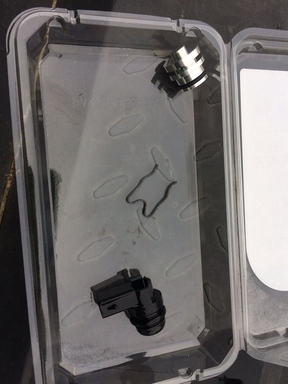

And... I've run out of parts for my Excursion! New alternator, wires, serpentine belt, a dummy plug in the tranny, '08 pan and filter. I'm feeling pretty accomplished
It has come to my attention that I should really have a cover for my driver's side battery and PCM.
I decided to hold off on replacing the solenoids for now. I don't have a garage/shop, it's cold out, and I'm not experiencing shifting problems. The possibility of having to remove the valve body to get at one of them was not terribly appealing yesterday evening, after dark, and I needed the truck today. Who knows - maybe they'll end up in the crew cab next spring as it is more likely to be hauling heavy loads.
Here's the old and new dummy plugs. I had to reshape that clip to get it to hold the new one in.
