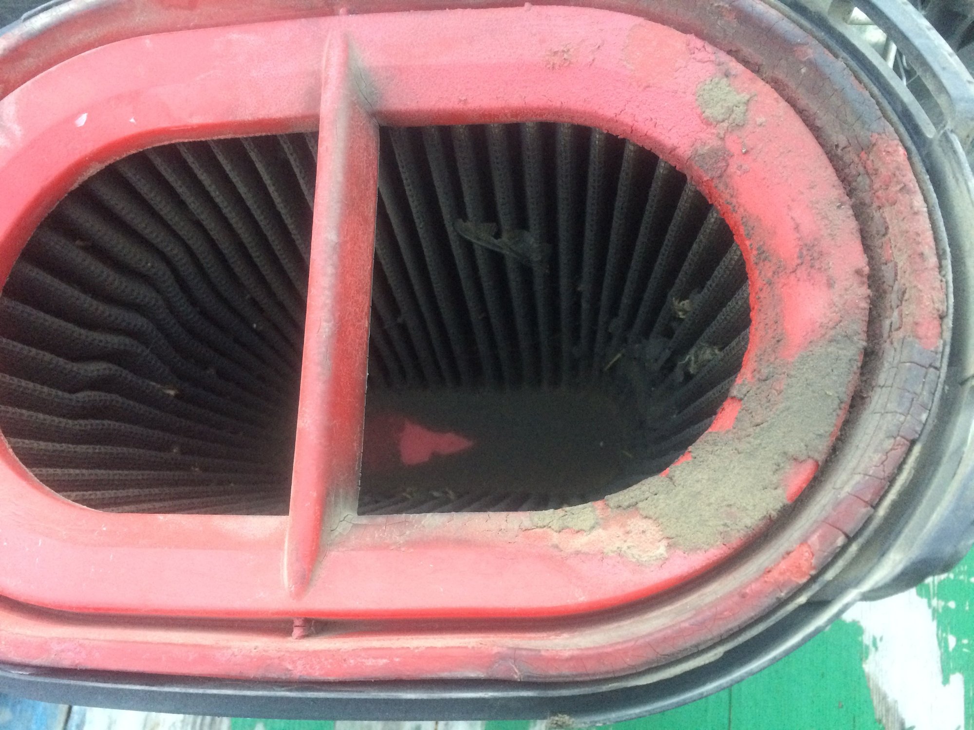

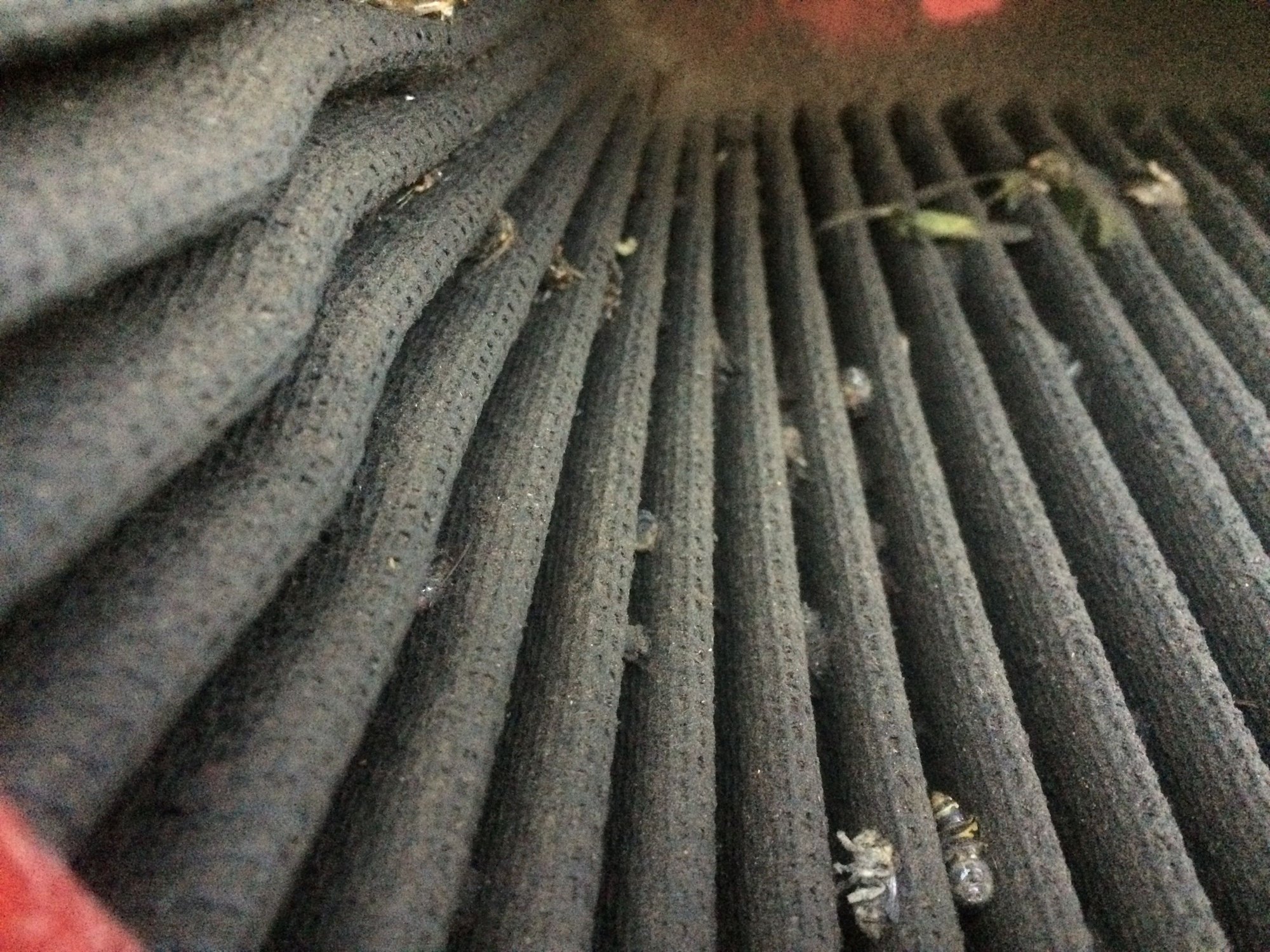

So... anyone want a slightly used AFE filter?

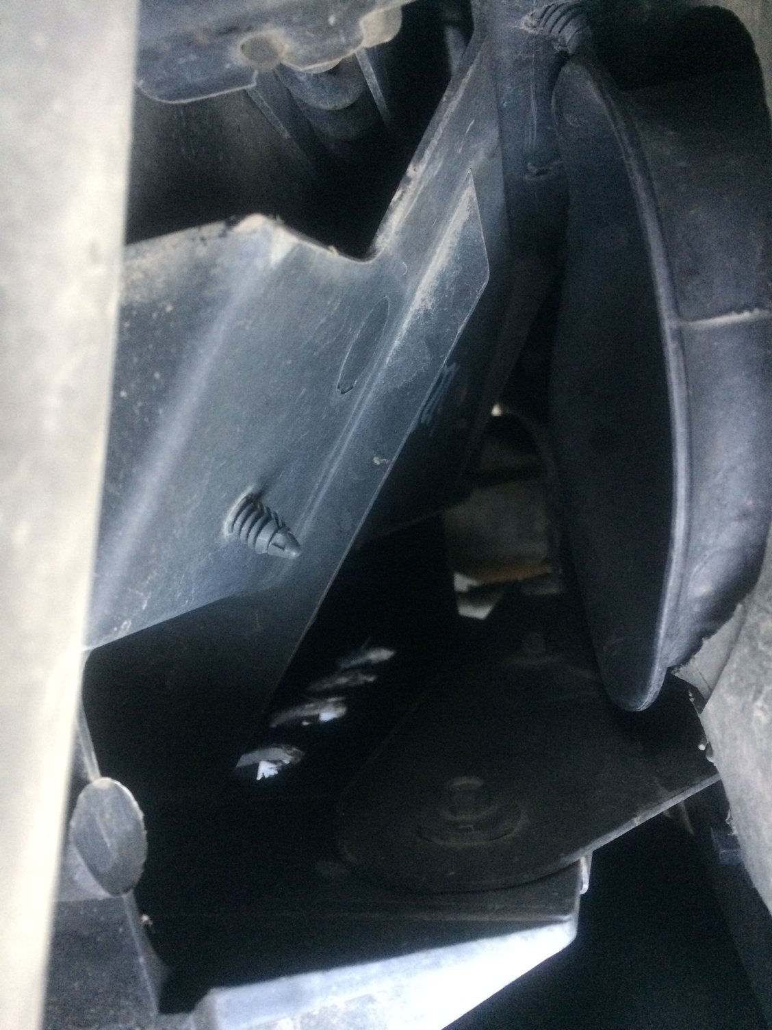

Here's the view from where it sat, looking out towards the grill
This is taken from the top so you can see the 4 holes someone cut to let it breathe a little

Ok, I just now got a chance to read through this, and maybe mine is set up how it's supposed to be? There were plenty of insects that found their way through somehow.

Guess I missed the custom AFE air filter set-up in the discription somewhere...
But now we know a way to increase your mileage
Let the engine have some air - that is one dang clogged filter!

Yeah, it was news to me, too. Apparently DH knew about it, and told me about it, but it must have been before I had any idea what the implications were. He was pretty surprised at how dirty it had gotten since the last time he checked it.

Looks to me like someone found a way to put it in backwards
That definitely would explain why your fuel economy is in the tank. Clean out that intake tube and clean your MAF, you should have a happier truck then.
